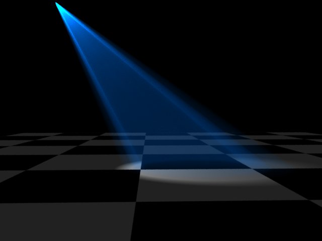

                  Are you trying to achieve something like this
                  spotlight.zip
                    [ATTACH=CONFIG]8752[/ATTACH]
                    [ATTACH]8751[/ATTACH]
                    That's exactly it. I'll try to dissect your scene to see what you did. Thanks a lot!

                        I'm not sure if I can find the scene, but in general it uses the VRayEnvironmentFog shader combined with photon-mapped caustics and dispersion in the V-Ray material.

                            Well, if you only need a flash light effect, it might not be necessary to use caustics as such... A simple spot or IES light might do.
