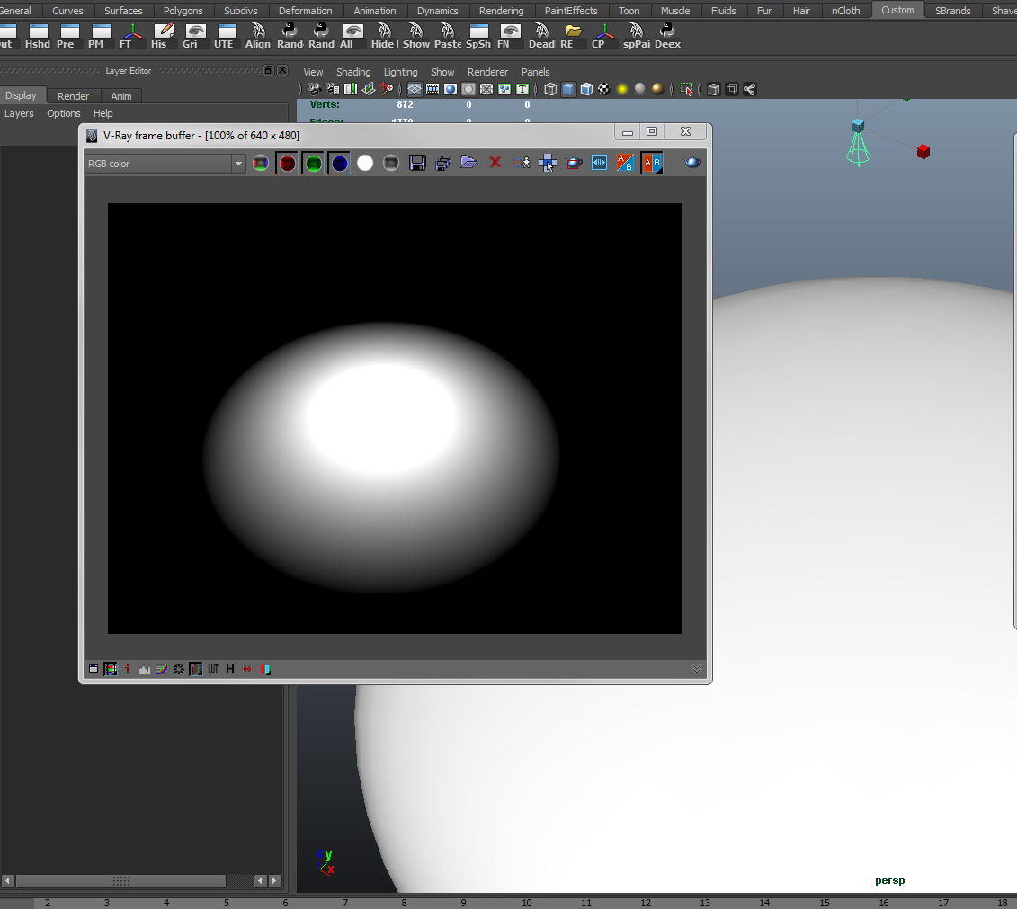

      One problem I have with Maya spot light is when using linear workflow, whatever value in the penumbra angle, I still have sharp edges. Is there work around?

        We have tested it here - and Penumbra angle is working even with Linear Workflow setup.
        Could you post some example scenes with screenshots of this issue ?

          Hi Svetlozar,
          I have attached a file showing what's happening. The spot light creates a bright circle.
                That's what you get with the Maya software and mental ray renderers, no? The V-Ray spot light has a parameter to control the falloff type, but it's not exposed in the UI; you can set it from the Python callback to smooth cubic falloff and it might work better.

                  Hi Vlado,
                  Could this option be revealled in the light?
                  regarding the result, I usually get some burn circle with Vray that i don't get with Maya software or MR. From recollection, the Vray IES light does a better job but require an ies profile
                    That would be odd, as in your scene, I get very similar results between the three renderers, burnt circle and all.
