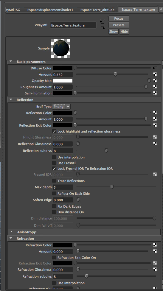

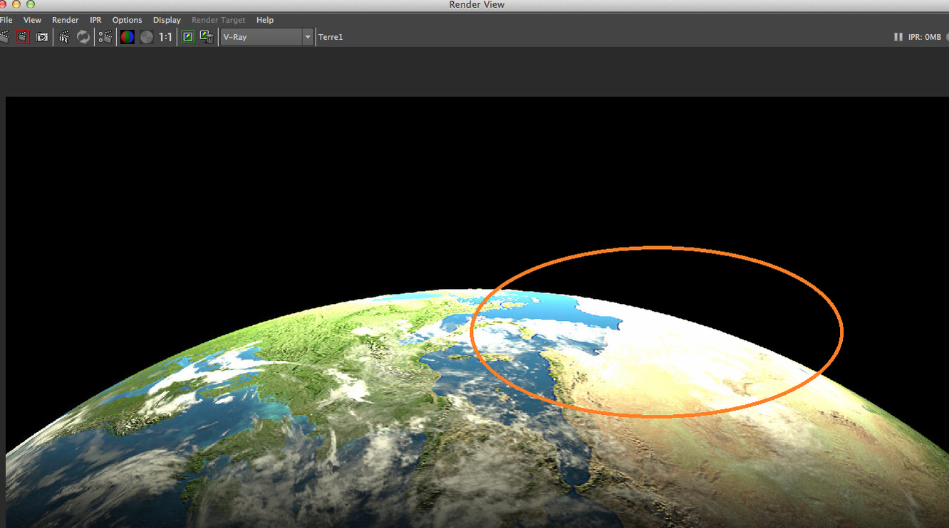

    I am currently working on modeling and rendering the earth, however I am unable to control the amount of brightness in the reflections.
    In the attached image, the sun (VRay spherelight) is above the earth, but despite I've set the reflection to 0 and refraction to 0, I still see the too bright reflection. How can I do to suppress/limit this reflection ?

    Is it really a reflection? What does the reflection render element look like?
    Vlado
      It looks to me like its hotspot from light...
        Is there any way to remove this hotspot ?
          move light further away from sphere. U can make it then bigger to compensate for distance that should soften the look and hotspot...
            Vlado
            Good catch. I looked at the reflection render element and it's fully black. The spot is in the lighting element. Will try to apply Dadal's proposal. Thanks.
              I moved it a lot further and increased his radius. The look is indeed soften, but my white spots are still there (slightly lower though). Will try to see if I can live with this. Thanks !
