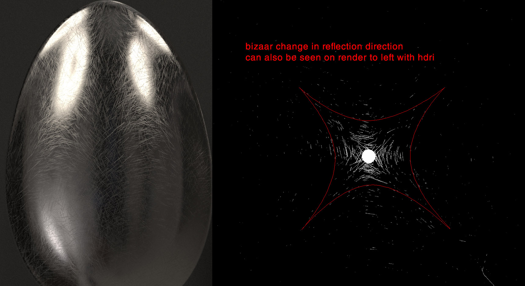

                      So here is render following the tutorial from the Alex's link, as you can see the scratches do not radiate from the reflection/light source but appear to be pinched. I have made a simple scene on the right of the image to illustrate the effect. Surely that cant be right or am i missing something, thanks in advance
                      matt
