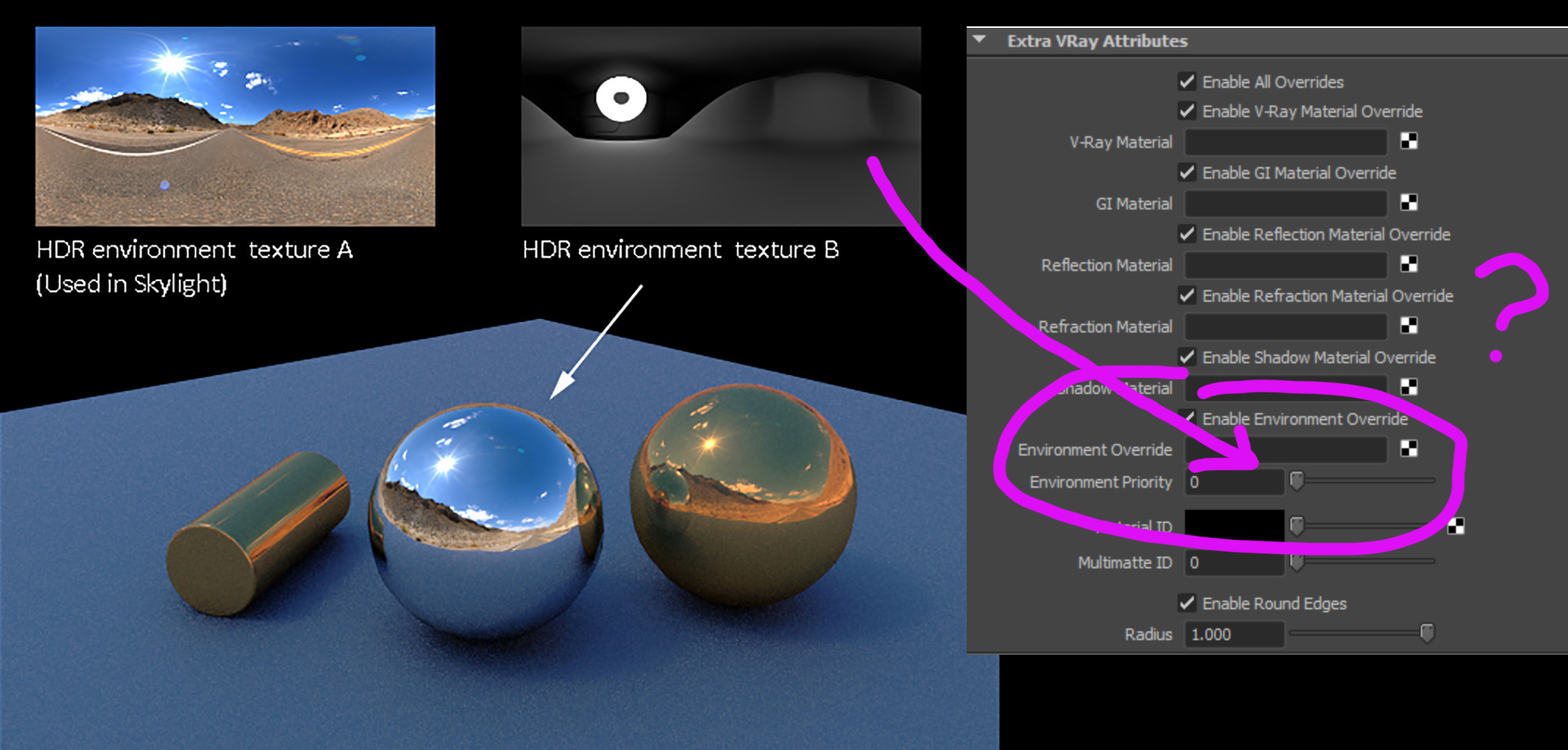

      Appreciate the reply, but I cannot get this to work in the attached image, all three objects are lit with the the SkyDome's HDR (texture A). I want to apply the chrome sphere's material with a material env, to change its reflections to the studio reflections (texture B). I have tried using the "environment slot," but it doesn't work. Perhaps the wrong approach?
      Thanks, Andrew

        Then you can connect a material to the reflections slot for the material override. The environment slot is what other object will see for this object (for example if the overridden object is seen in the reflections or refractions of other objects - that's what its environment will be in those refl/refr).
