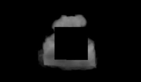

      Actually can you post or send an image? I thought I saw something strange, but it's better to check your case.

        Sure thing - The black square is the rect light, and it's actually set behind the Phoenix container in 3d space. This is visible in the RGB and Alpha
          We can't seem to reproduce it here. Is it possible to attach a simple scene so we can see where the problem is?
