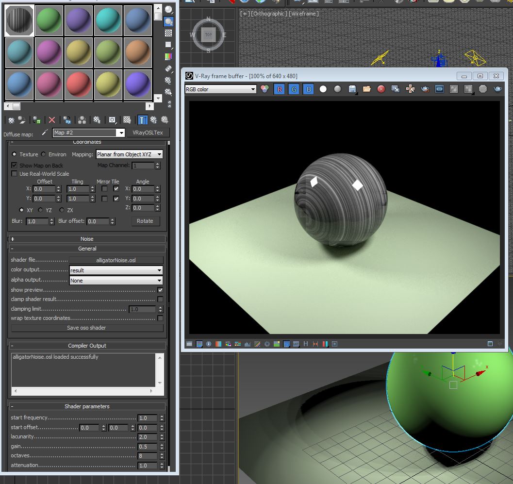

    • Originally posted by YoyoBoy View Post
      How do you make these work? I just get stripes.
      [ATTACH=CONFIG]32598[/ATTACH]
      That's what I seem to get too.
          Apparently it's one of life's mysteries, Strob.
          Works fine for me, but I'm using Maya rather than Max... maybe try raising the frequency to something like 20. Also try looking at it on a primitive plane rather than a sphere since it's a 2D texture.
          • Nah, it doesn't matter what object you map it to, you just get perfectly vertical stripes, regardless of the object's orientation. Is this a problem with the shader, or with VRay OSLTex for Max?
            - Geoff
            • are you doing precisely what the instructions say (no "wrap texture coordinates" checked in the sample posted above)?
              I tried the lot, they work flawlessly with volumes and objects (provided one doesn't try to map the 3d noise field to a 2d UV map...).
              So set the mapping to Object space, and turn off "wrap texture coordinates".
              Then it'll work.
              Lele
              emanuele.lecchi@chaos.com
              Disclaimer:
              • It's probably just a Max thing. I didn't realize this was a Maya thread when I complained.
                - Geoff
                • Though I guess that begs the question: should it matter? If it's all VRay, shouldn't it work for any version?
                  - Geoff
                  • The Max and Maya implementations are a bit different since in 3ds Max we have to go through its own rendering API for textures.
                    Vlado
                    • Ok sorry I didn't notice it was a Maya thread neither.
                      At least we now know it doesn't work in max. So maybe it should be specified in that OSL Additional procedural noises page.

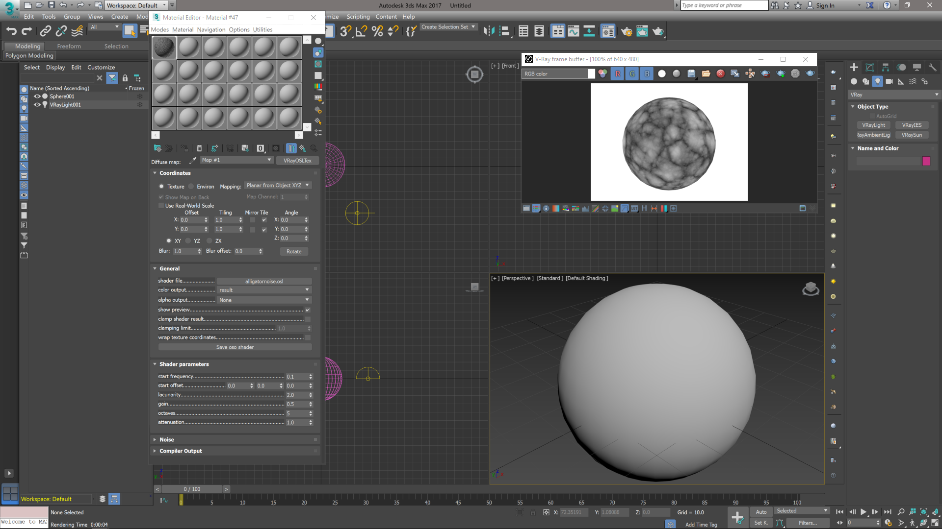

                      • The thin film shader is working in max and is really cool!

                        • While i'm not aware of any change between 3.40.03 and the nightlies, this worked before 40.03 was released and afterwards (meaning it's either broken in the specific version, or there is some other user error).
                          Notice that's load -> change frequency from 1.0 to 0.1, render.

                          • I am looking into the problem.
                            Could you please specify the V-Ray version you are using - I am having trouble reproducing the issue with my version.
                            • Originally posted by Ivan Mavrov View Post
                              my versuion is
                              3.40.03
                              __________________________________________
                              www.strob.net
                              Explosion & smoke I did with PhoenixFD
                              Little Antman
                              See Iron Baby and other of my models on Turbosquid!
                              Some RnD involving PhoenixFD
                              • Same here. 3.40.03
                                - Geoff
