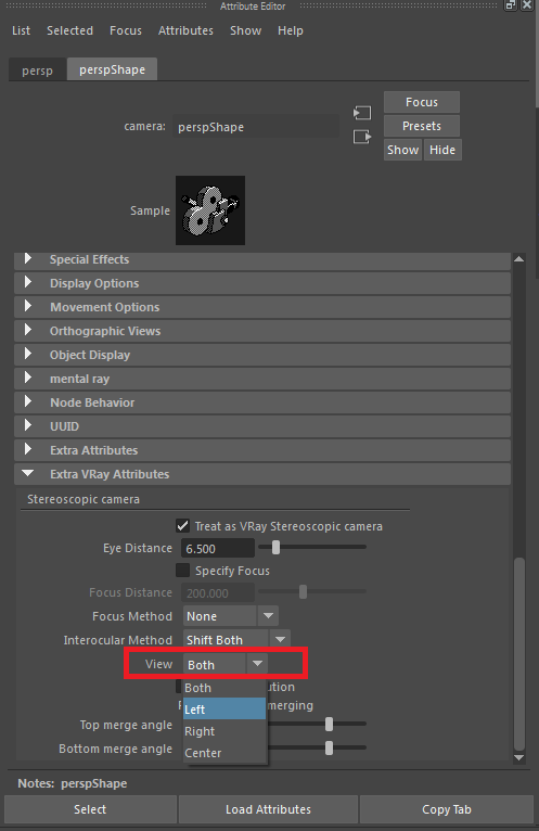

    Is there any way to render left and right eye separate if I'm using new stereoscopic camera attribute ?
    It looks like I can only render side by side (one image per frame with both eyes), I'll like to have a option to render separate image for left and right eye.

    You can tell V-Ray which eye-view to render from the "view" option in the stereo camera attribute.
    (see the attached image)

      I'll like to render both eyes and to save two images separated (left and right) ... Maybe solution is to duplicate camera and render 2 cameras with different eye selected ... I'll try that..
        maybe render layer with layer overrides? You will be able to render them in one pass in batch.
