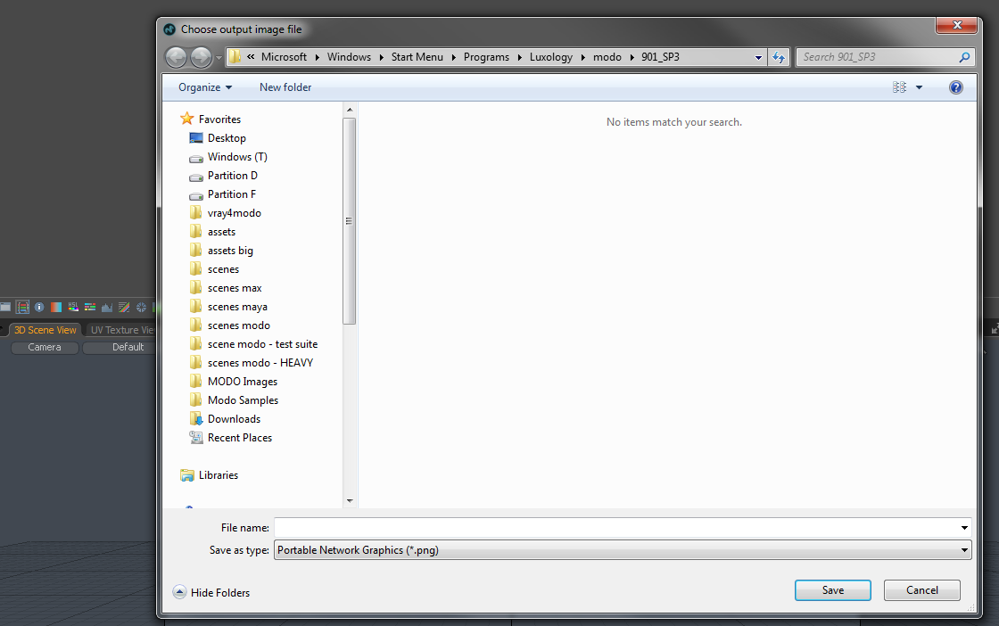

      Do you think changing the "Choose output image file" dialog to the standard Windows "File open/save dialog" will work better than the Qt dialog we use now ?
      The Windows dialog has the "Favorites" list on the left side, which is shared across all Windows applications that use this dialog.
