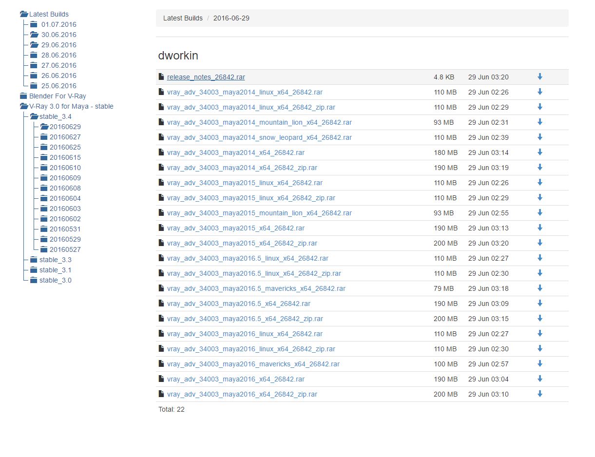

                    Hi Guys,
                    I'm still having a few issues when getting these features to work on the GPU with the latest nightly build I can find.
                    This is the version I have downloaded:

                    I've tried a production render as well as an RT session with no success. Do I have the wrong development build?
                    Also could there be some setup process I have not properly setup to get VRay working properly with the GPU or should it be automatic?

                          Uh, unfortunately it seems like you don't see the nightly builds that you need. We have two branches - stable nightly & just nightly. The stable nightly is basically almost like the official build and we try to move only critical fixes there. The regular nightly builds have all the latest fixes, but they are not as well tested, since they have the changes from the last day and are a bit more dangerous to work with. I will try to find out if it is possible to give you access to the nightlies you need and will get back to you. Sorry for the trouble, Best, Blago. Edit: also it is the stochastic flakes mtl that got support in the nightlies .. It is much better than the regular flakes anyway. The rounded edges will be added in a day or two to the stable nightlies as well.

                            Thanks for confirming this. It would be great if you could grant me access to these builds. I have a large amount of Phase One backplates and HDRIs to render with and It would be great to do them with v-ray GPU.
