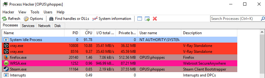

    I noticed my workstation was running a little sluggish and I did not know why. I opened up Process Hacker to see what was running and I have 3 vray.exe processing running, two of which are sucking up 25% of my CPU resources. Point is, Maya is not even open and there is nothing running. I have 3 installations of Maya (2015,2016,2016.5) all of which have Vray installed. I just installed the latest 3.4 version. I'm use to seeing the vraymayaspawner running in the background but was surprised to see vray.exe running when, to my knowledge, nothing is being rendered. Like I said, Maya is not even open. While these process are not taking much in memory resources they are visibly taking up compute resources. Is this normal? Did I install something incorrect?

      Well, I might be able to believe that. But..... I restarted my workstation and the processes were not there. I then started Maya (2016 in this case) and quit Maya never even loading a new file and the procesess show back up so I'd say no, it is not because an RT rendering session that failed to close.

        Hi,
        Could you please attach a screenshot of the Task manager Command line column for the vray.exe process ?
