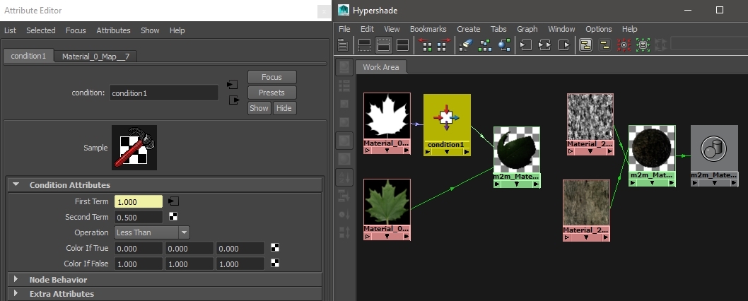

1. "The File node is already an equivalent of VRayHDRI" - you mean the normal file tex from maya?
2. I set the texture filter from maya to off and insert the filter like your hint - Renderspeed goes from 2min12 to 2min30!
3. I pluged in the condition node - no difference - but perhaps I set it in a wriong way? (never used before)
btw. the alpha mask has only at the mask edges other values than 0 or 1, sure that the condition node makes sense in such case?
...please see the attached images.

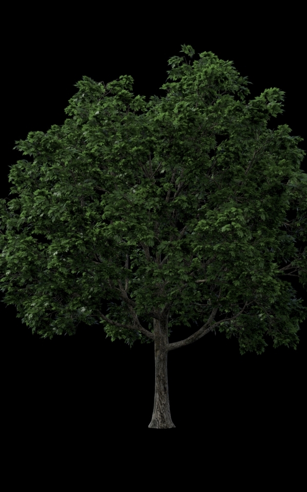

It´s a tree from Evermotion (Vol58, nr35)

made some test´s here and can not confirm your hint´s - but perhaps I made a mistake?
