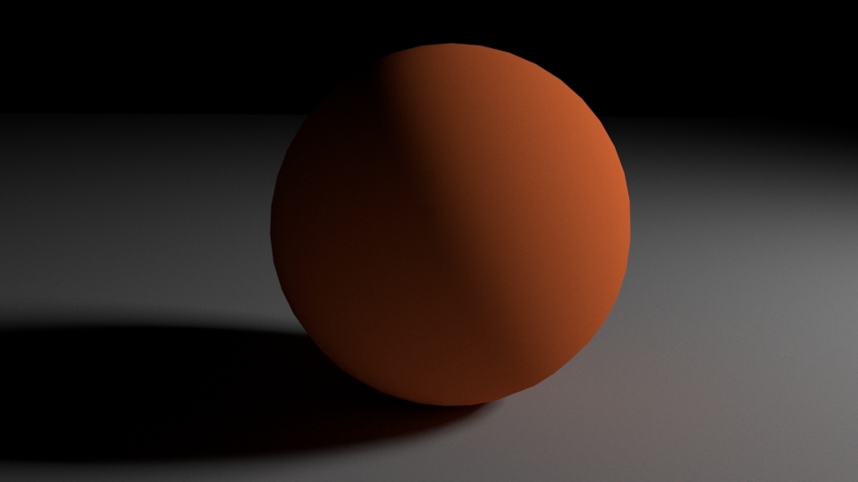

                              Hi Yolov,
                              when i render your scene from the perspective view i just get an orange ball, what values did you set your near and far to on distance blend mode?
                              Also what was your reasons for using distance blend?
Name:	distance blend.jpg
                              If i switch to towards away i get something that looks quite usefull
                              thanks
