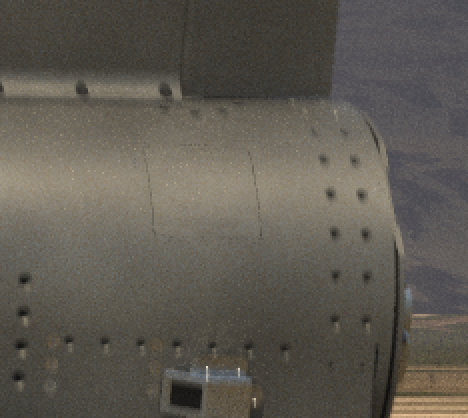

                        Update: We have exported the animation as a vrscene and thought that this is the solution, but nada. We still have the popping and the massive deconstructions (see image). I mean there is no motion path and no grouping when exporting to vrscene, or? Will now try the alembic export. Is there any way to keep the shaders assignment intact?

                          Yes, the vrscene is "flat" in terms of transforms, grouping, etc.
                          However, we still depend on Maya to give us the correct "flat" transform. The problem lies in the Maya->V-Ray connection somewhere, so exporting to vrscene will not be any different than an actual render.
                          The problem could be a Maya API bug or maybe we are not using the Maya API correctly in this case.
                          Unfortunately, we did not manage to reproduce the issue on our end, so it would be great if you can send us a scene. It doesn't have to contain the original geometry or assets, cubes will do, as long as the MB issue is still present.
