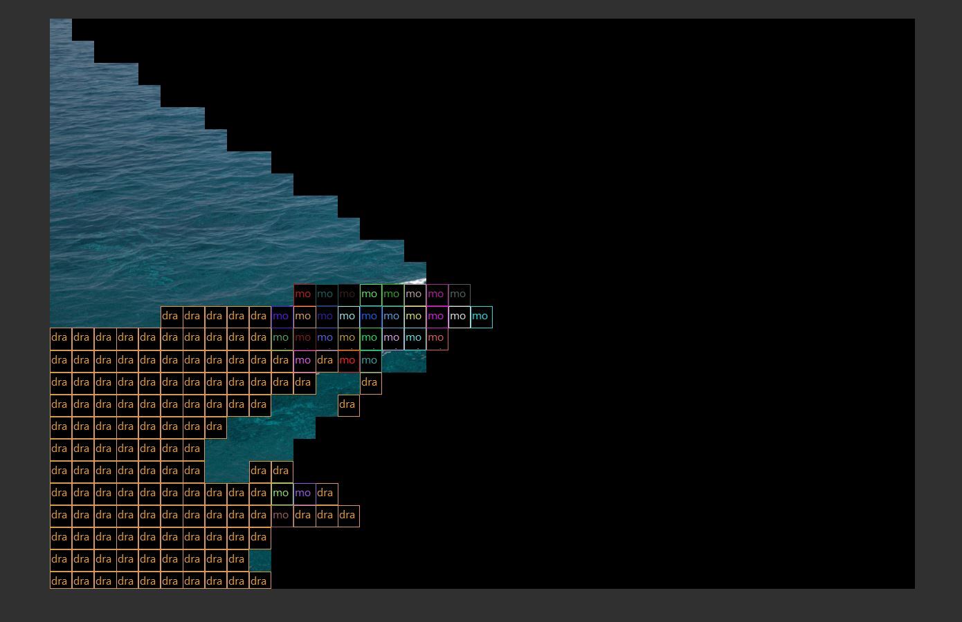

            Last but not least...
            I did a DR test launched from the 16 core workstation with the 64 core as slave (from Maya interface). I can confirm that there are 32 buckets for master (CPU at 96% average) and 128 buckets for slave (CPU 38% average) ! Damn !
            [EDIT] File was sent, ticket number: 1241
            Click image for larger version  Name:	buckets.JPG Views:	0 Size:	94.6 KB ID:	1122398Click image for larger version  Name:	cores.JPG Views:	0 Size:	94.8 KB ID:	1122399
