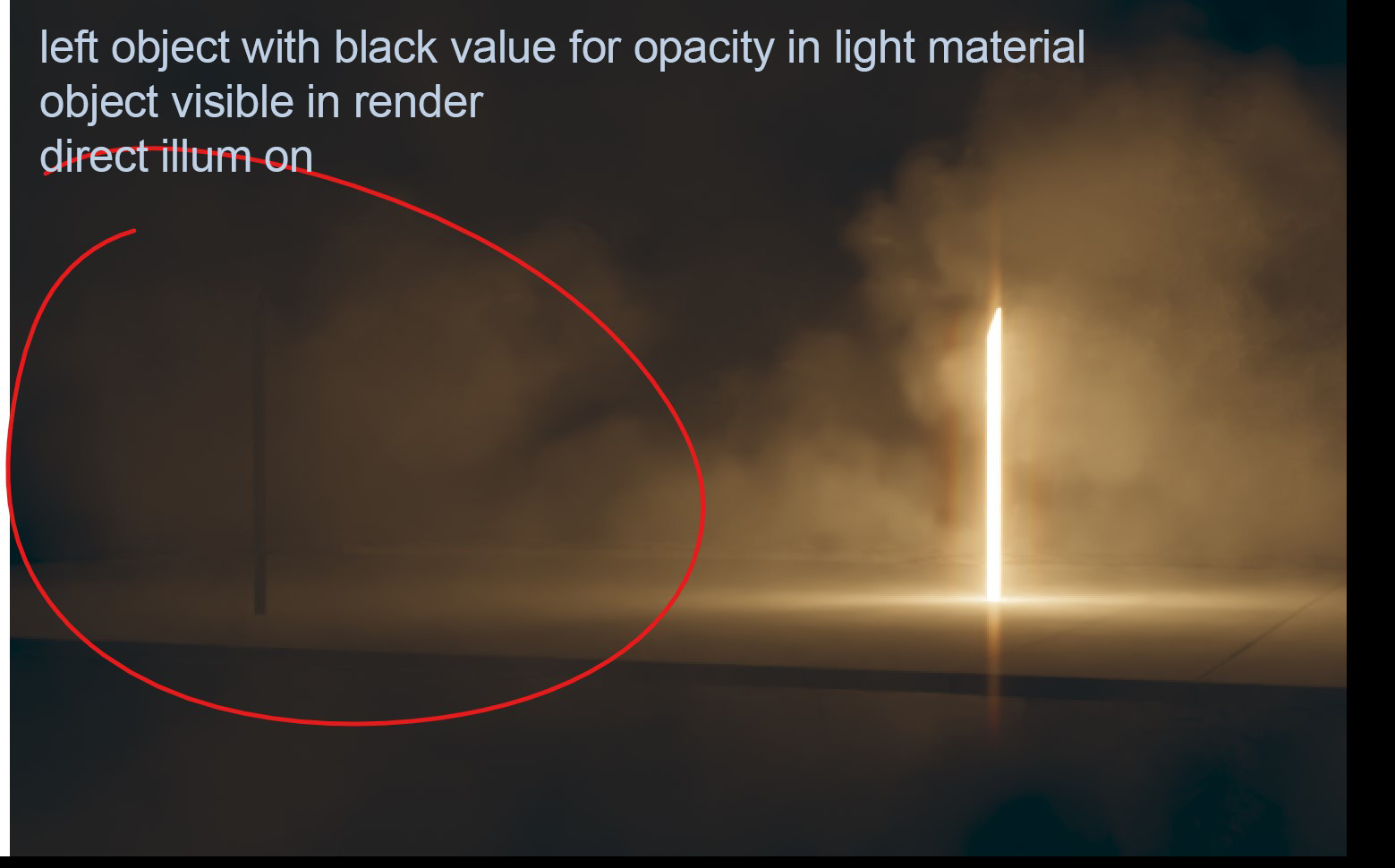

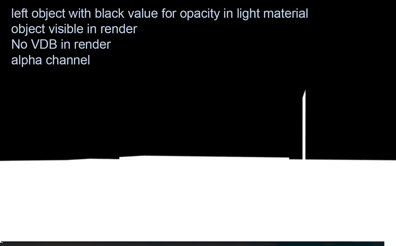

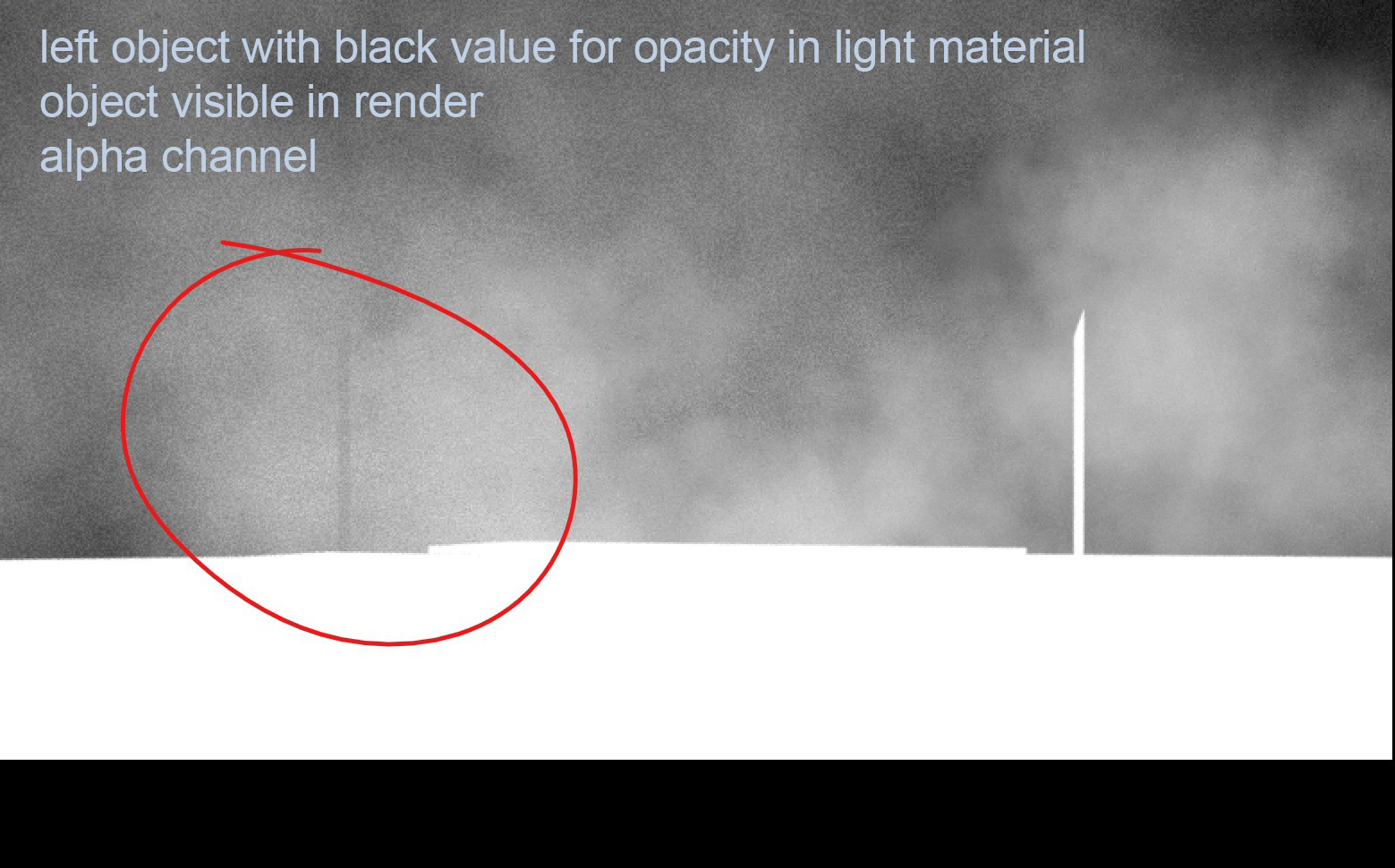

                Ok, here's some screen grabs from the scene I sent. I cant guarantee the scene is working as it is on my end.
                I was not expecting to see anything rendering when the opacity was black, but I can see the geo in the VDB. Even if I turn colour to black, and multiplier to black, I can still see rendered geo in the VDB. If I turn the VDBs off, the geo disappears, as it should.

                  And here are the renders when I hide the VDB. No geo visible, nothing in the alpha.
