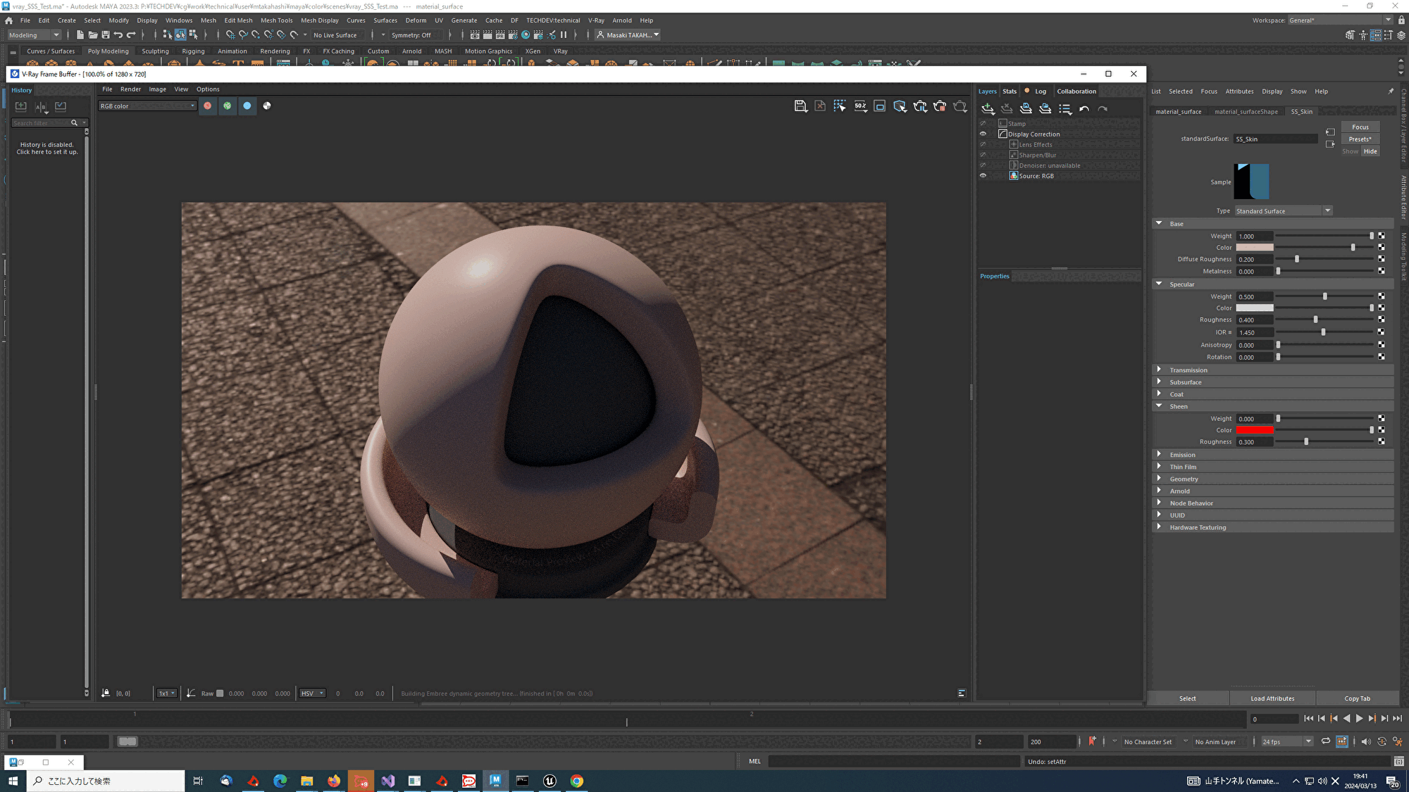

    I wanted to inquire about the materials in V-RAY for Maya, specifically regarding the Maya Standard Surface material.
    No matter how much I adjust the parameters for Subsurface, Coat, and Sheen in the Maya Standard Surface material, I don't see any changes. Is this intentional?​​

    Click image for larger version  Name:	vray_StandardSurface_Coat.gif Views:	0 Size:	1.86 MB ID:	1205218Click image for larger version  Name:	vray_StandardSurface_Sheen.gif Views:	0 Size:	1.82 MB ID:	1205217Click image for larger version  Name:	vray_StandardSurface_SSS.gif Views:	0 Size:	1.80 MB ID:	1205216

    Sorry to say, StandardSurface's dispersion, sheen, coat, and SSS are not yet exported for rendering in V-Ray. Is there a reason for using Standard Surface instead of a VRay Mtl?

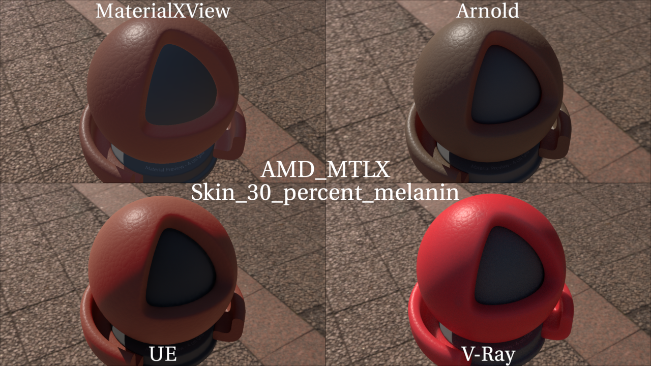

      The reason we prefer to use Maya Standard Surface is because we are currently investigating achieving a unified look across DCC tools using MaterialX. We found that the subsurface scattering (SSS) did not achieve the correct appearance with vrayMaterialX. Therefore, we are considering whether we can standardize using Maya Standard Surface instead.
      AMD_MaterialX_Library:https://matlib.gpuopen.com/main/mate...ll?search=skin

ID:	1205440 Click image for larger version
ID:	1205441 Click image for larger version
ID:	1205442 Click image for larger version
