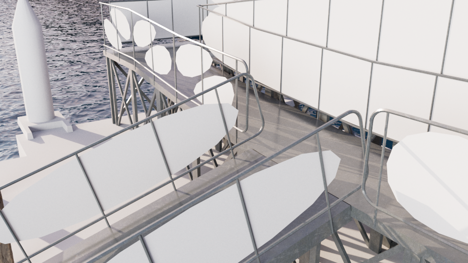

    Just started using Megascans assets in Maya /Vray 6. Does anyone know why some geo gets stuck in smooth mode? In the viewport it's not smooth, when rendered some geo gets smoothed, and I can't unsmooth it?
    Any help / hints is appreciated - look at attached images -
    Maybe it has a VRayDisplacmentMod attribute set to Subdivision (or OpenSubdiv attribute) active?
      Thanks Hermit Crab, that's probably it. Is there any documented workflow for using Megascans with Maya / VRay? I've come across tutorials for Max, but not Maya?
