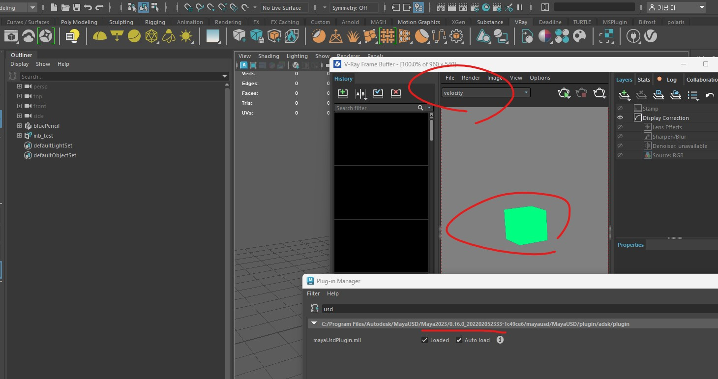

    I tested Maya 2023.3.1 mayaUsd 0.16.0 vray v6.00.02.
    Render velocity pass!
    But I used Maya 2025.2 mayaUsd 0.27.0 vray v6.2
    Not rendered

      Thanks for the report and the provided scene. I've logged it (internal bug-tracker id: VMAYA-13324) for developer investigation.
