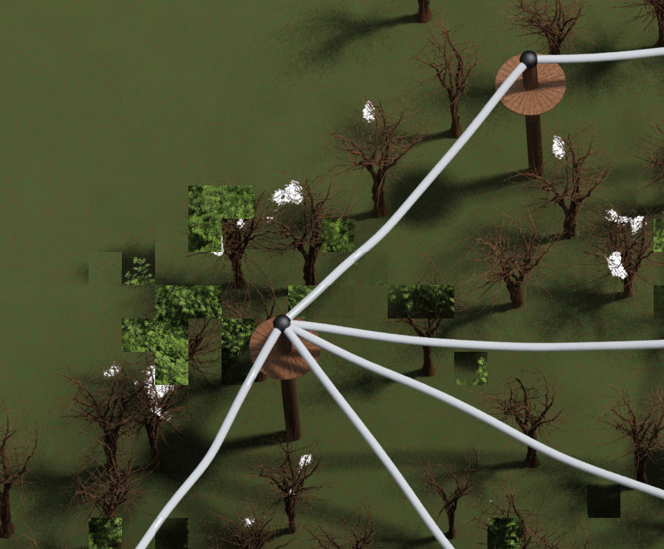

            The service names are Vray Maya Spawner 2010 (the target is vraymayaspawner2011.exe)
            So why do they have that 2010 name?
            I did a render and as you can see, all the slaves didn't render the leaves....
            So, if I start the render slaves manually on every machine, everything works fine -
            I am totally confused...
            What am I doing wrong?

                I think there is a problem during the compilation and maya 2011 build uses improperly some files from maya 2010 build. Will check this out.
