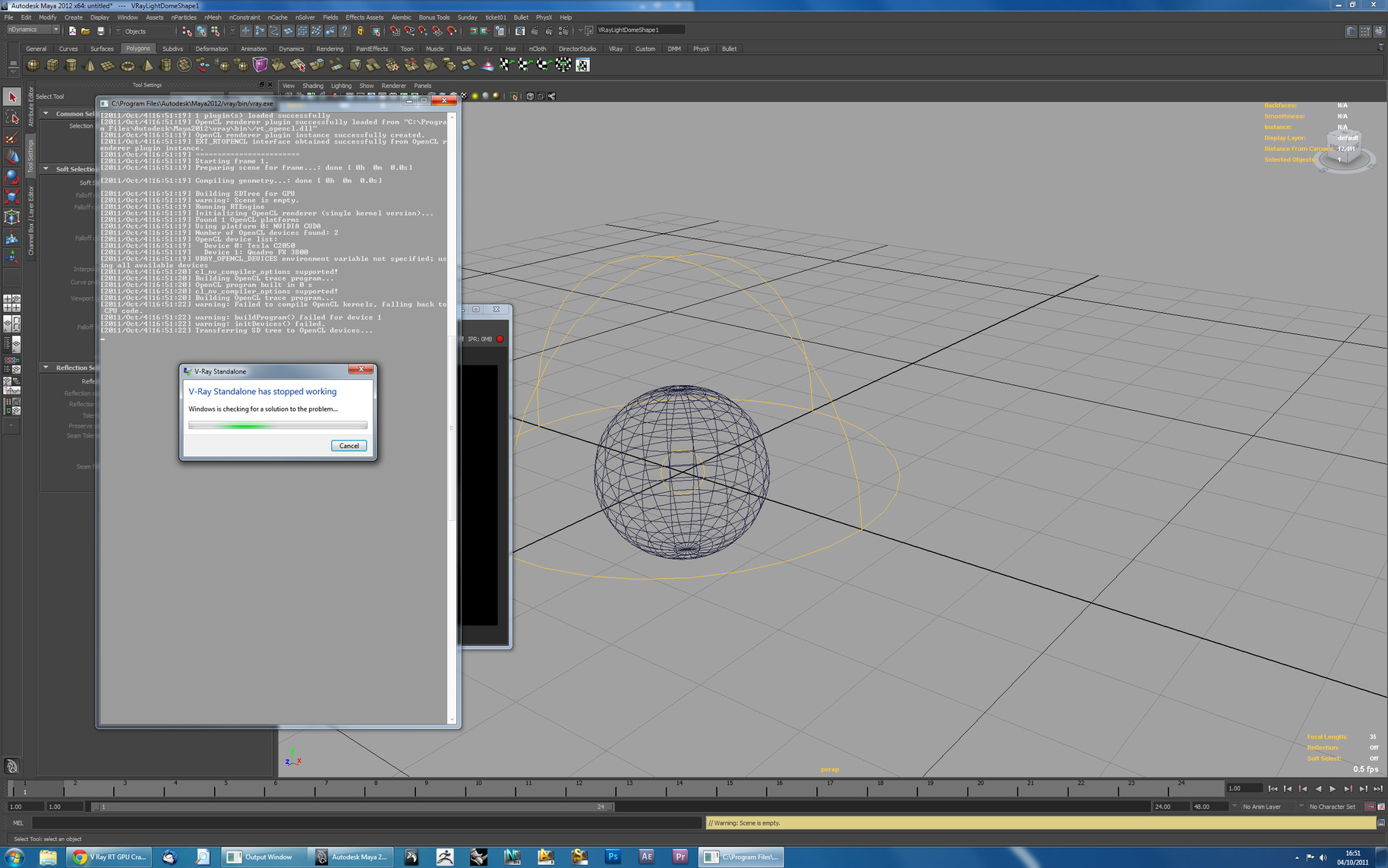

            I have just tried 270.90 and I still have a crashing command window.
            I have attached an image illustrating the problem:
            Edit: I definitely have 64 bit V-Ray Installed.
            Director & 3D Artist at Focal CGI
              Thanks for the screenshot - it seems to be because the two graphics cards have different architectures - the Tesla is a Fermi card, while the Quadro is not. You can try disabling the Quadro card from the V-Ray RT OpenCL device selector utility from the Start menu and see if this solves the problem.
