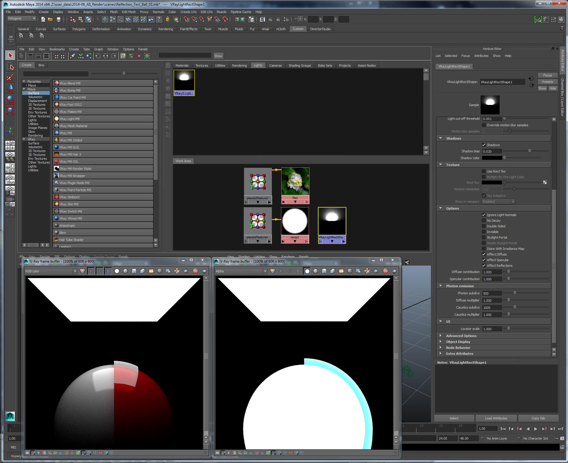

    So, is there any way to reflect an invisible light on a surface behind a transparent surface? I did a search but could not find a straight answer. I'm trying to light a tail lamp with a Vray rectangular light and there seems to be no way around this.
    Attached are screen grabs of a sample scene; before and after making the light invisible.
    Hi,
    It is a bug and we will fix it.
    Thanks for your report.
