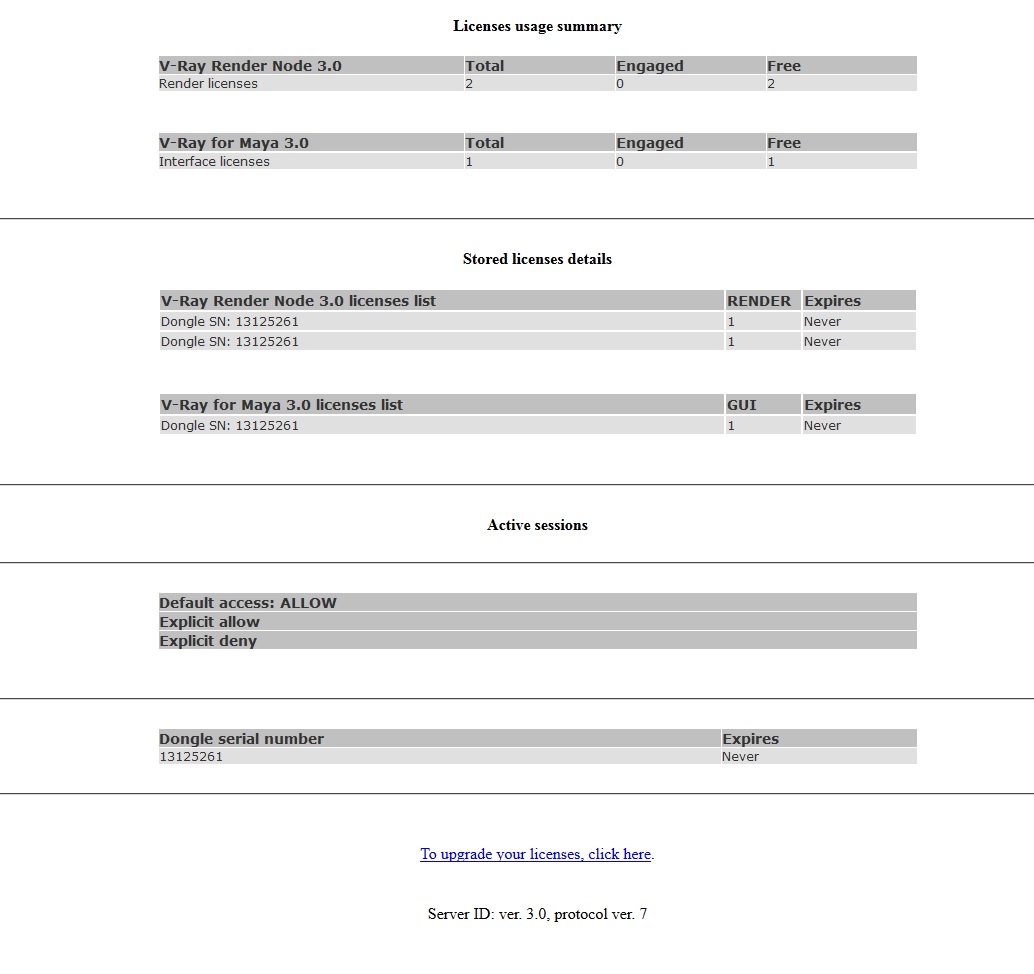

                        Another question - just to confirm - do you see 2 render node licenses in the license summary when you open up localhost:30304/getstatus in a browser on your main machine (where the license server is running)?

                            The dongle was updated weeks ago when i purchased the additional license. Here is my summary from July. All of this happened after updating to Maya 2017, and installing the latest Vray for Maya 2017 yesterday.

                                Also, the summary is showing two render node licenses.
