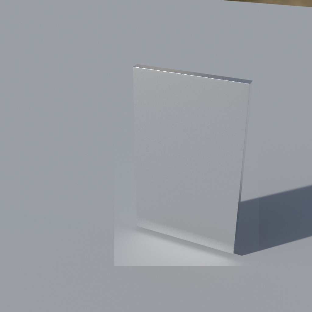

    Hi, im getting an unexpected result when i change the ansiotropy setting to 0.8 on a poly smoothed object. If the ansio setting is at 0, then its fine, but set it to 0.8 and you get the 2nd image result. If you unsmooth the object it works ok at 0.8. But see my post after this, as theres another issue with that.
    Click image for larger version  Name:	ansio_zero.jpg Views:	1 Size:	422.0 KB ID:	990023Click image for larger version  Name:	ansio_08.jpg Views:	1 Size:	433.2 KB ID:	990022
    So something is getting corrupted after using the smooth tool in maya.
    This is latest version of vray...maya 2018.2....scene attached.

      Hi,
      This is a known issue that we've just fixed. We'll see if we can port the fix to the stable builds so you can get it.
