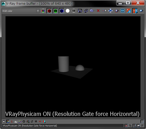

    Please port a feature like "VRay Exposure Control" of VRay3dsMax.
    same exposure as all the cameras can be applied, or exposure control can be applied, without changing the angle of view of a Maya camera.
    (For example, when using "Fill" by Fit Resolution Gate)
    It is very important when a match MayaSoftwareRender[or other Renderer] and V-RayMaya.
    Thank you.

    Such control doesn't exist because PhysicalCam-attribute could be assigned to any camera.
    Fill option in Fit-Resolution Gate matches perfectly in Maya's Camera , and VrayPhysical Cam.
    I have added your request into our system - but it would be helpful for us if you provide us some examples where matching-cameras between Maya's Software and Vray is not possible.
      Originally posted by flat View Post
      same exposure as all the cameras can be applied, or exposure control can be applied, without changing the angle of view of a Maya camera. (For example, when using "Fill" by Fit Resolution Gate) It is very important when a match MayaSoftwareRender[or other Renderer] and V-RayMaya.
      You can already to that. Set the FOV mode of the physical camera attributes to the "From Maya camera" and it should match exactly. If you have a scene where it doesn't, please send it over so that we can fix it.

        oops and I am sorry.
        Fill option of Fit-Resolution Gate is supported in Nightlies.
        It was checking by 2.30.02.
        advised that Nightlies is used for my customer.
        Thank you!
