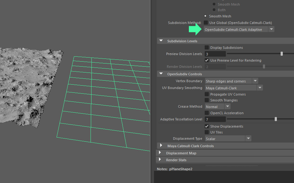

    looks like vray does not support the new adaptive subD in the viewport...
    this is also breaking the viewport diplacement... it does work if i use a blinn shader...
    This type of subdivision is supported with V-Ray, only it's disabled by default. You can tick "on" this option in Render settings > Overrides > Geometry > Viewport subdivision.
    For viewport displacement, if it's done by the shader it should be supported. If you're using V-Ray's displacement node, there's an option to tell it to use the displacement shader (VRayDisplcament node > "Override Global Displacement") and it can be used in combination with all the displacement control attributes that can be attached to V-Ray's displacement node.

      cant get it working...
      the plane is just invisible in the viewport...
      select it in the outliner...
      disp.zip
        It seems that we actually don't support this, I'll log it as a request. For the moment this won't work with V-Ray, unfortunately.
