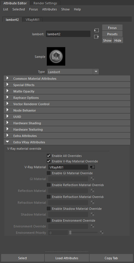

    A quick workaround is to use a lambert for your shader on the MASH geo but then create a VRay Material override on your lambert shader and then assign the VRayMtl to the VRay-Material override slot. Boom viewport display and rendering! An old trick I used to have to do to make Mental Ray show anything worthwhile in the viewport, just in a VRay way.
