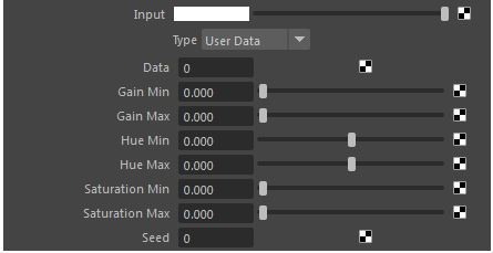

                  Wasn’t there with Vray 5 introduced something? Not sure, but remember to have seen a video...
                  Thanks for reply
                    I guess you may have seen the random hue/sat/gamma in MultiSubTex.
                    You can try just adding a MultiSubTex and you can add a single flat color (or texture) that can be randomized.
                    Alex Yolov
                    Product Manager
                    V-Ray for Maya, Chaos Player
                    www.chaos.com
                      Just doing some trees and yep, quick randomization of hue (but also other stuff) would be handy. Something similar to hair shader.
                        You can use the MultiSubTex to randomize the hue/sat/gamma.
                        You can even pass a single color (or texture) value instead of a whole list of colors/textures and this will randomize the colors for every object that has this shader assigned.
                        If that's what you're after, you can give it a try with the MultiSubTex.
