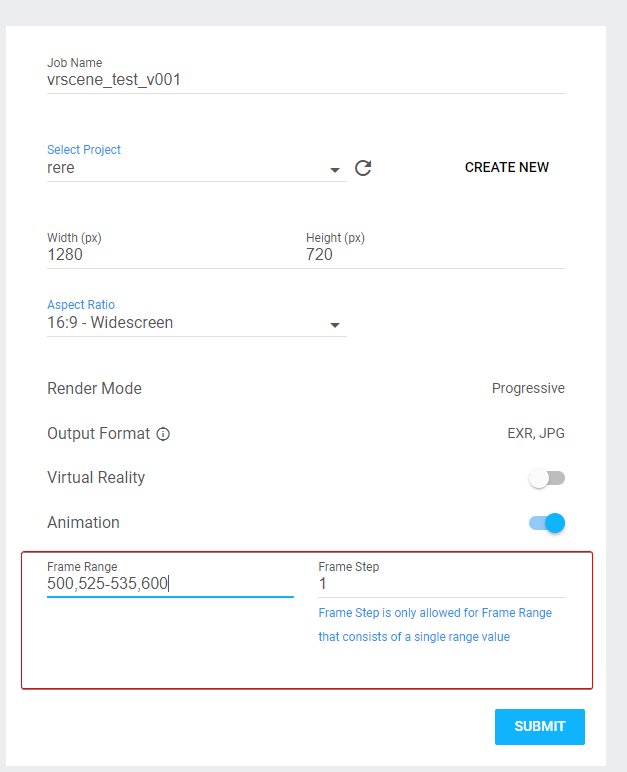

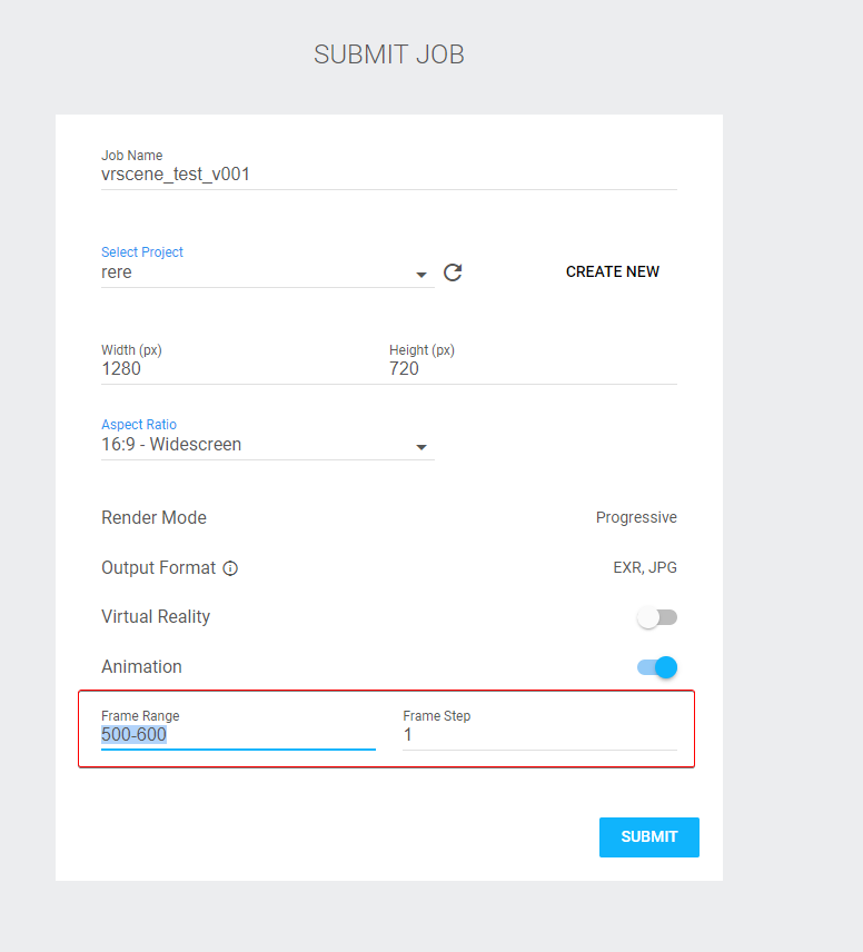

    - In a simple test I had my scene range to be 10-20. But when exporting a .vrscene it seems like it exports frames 0-120 for some reason? If I had my range at 500-600, it seemed like 1-100 was exported, but I guess that it's not using actual frame numbers in that case?
    Check the attached file to resolve the issue :

      Yes, there's no problem when rendering frame ranges via vray cloud. I was just testing different things to reduce the size of a .vrscene file when I saw the odd behavior. So basically I just used File/Export/Vray scene.
        You can reduce the vrscene file slightly by using the custom option.
