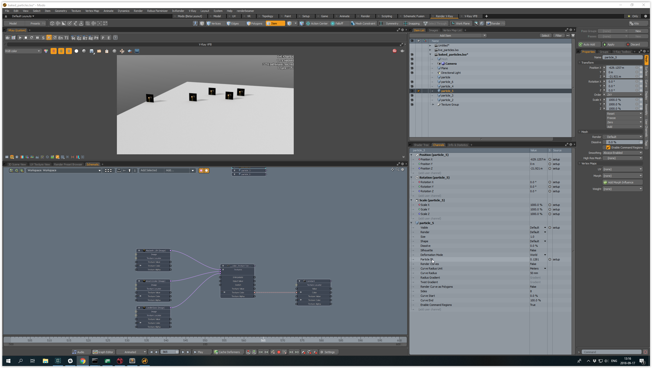

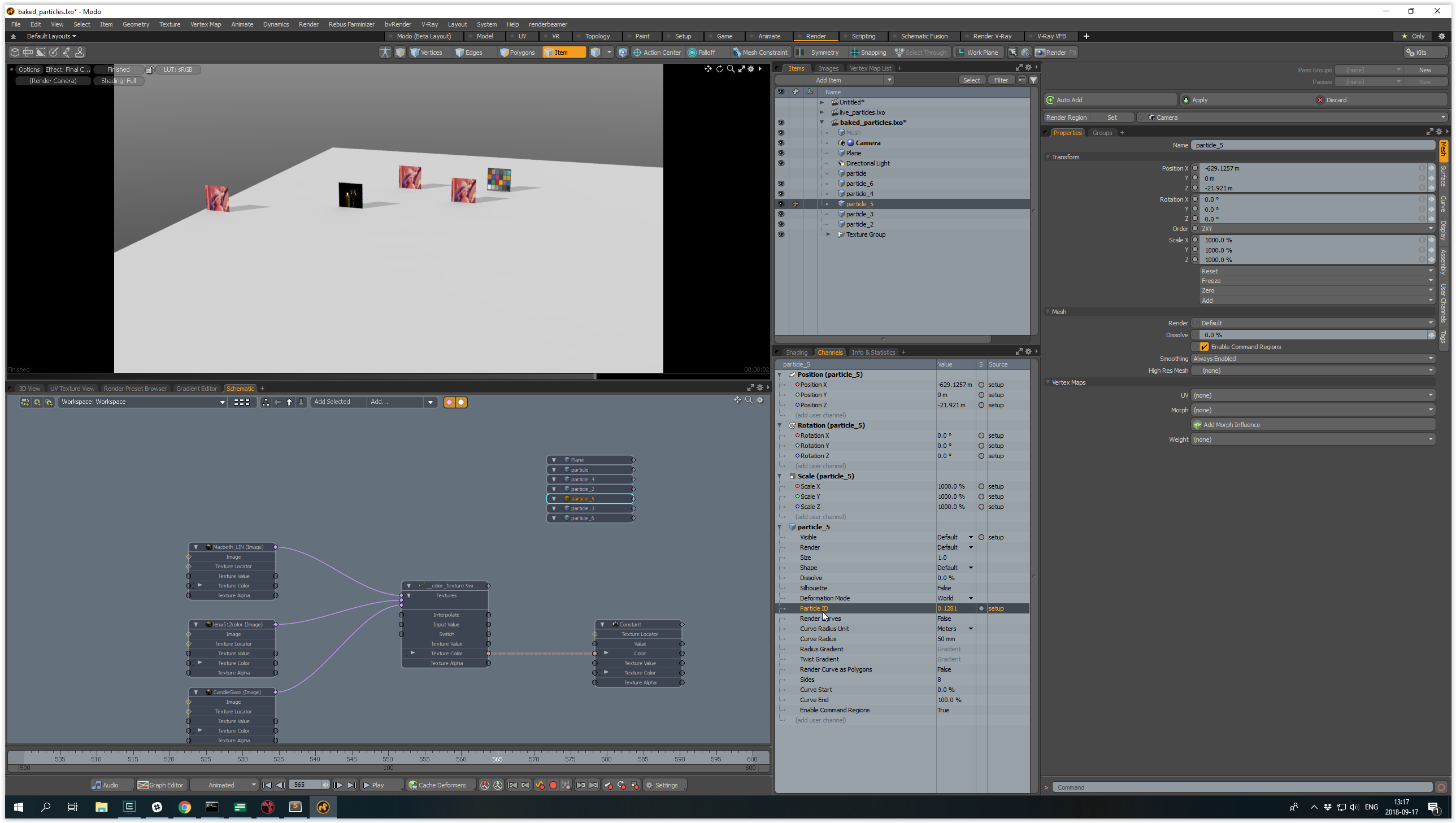

    I'm trying to randomize textures for lots and lots of patricles using the Texture Switch node. It all works great when I have the particles "live", but as soon as I convert the particles to meshes, it all breaks. It's somewhat expected to break as modos "freeze replicator" command doesn't preserve the particle id channels. But even if I set the "pid" channel for each instance to be the same as it was when it was live (using a custom python script) it doesn't work. It does work in modos internal renderer though.
    Is vray not using the "pid" (particle id) channel for meshes when they are baked? Can I work around it somehow? I see there's a Vray Switch Matrial node, but not sure if that can replace the Texture Switch. In my production scene I'm going to have hundreds of different images that I want to randomize.
    See attached screenshots and sample scenes.

    If I have correctly understood your issue, you can reuse the Texture Switch in conjunction with a Variation Texture on your frozen meshes.
    Just set the Variation Source to Item and use the value curve to drive the distribution.
    There is also Texture Particle as a Variation Source setting, maybe it's what you're looking for ? ( I've never used this kind of setup with particles )

      Thanks, yes that works .
      Texture Particle sounds super intresting, but I haven't found any more info regarding that.
      When testig this further I also noticed that I also can't use "Mesh part" when an item is converted to a VRay-Proxy. That would have been the best. Anyhow, I guess the item version will work for now.
