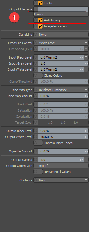

    Hey, Jeff,
    Thank you for the feedback. This option is not implemented yet, and we're working on it.

    You can try with Object ID RE and use "Shuffle" node for a cut right before to use zDefocuse node.
    Click image for larger version  Name:	modo_2019-09-09_11-24-26.png Views:	1 Size:	91.5 KB ID:	1047515

      Hi Boyan,
      Thank you very much for your quick reply. My understanding of what you've posted above is that it's a workaround for creating the depth pass without any AA applied... Does that mean that the images I've posted above still look like that's the problem?
      Thank you very much for your time.
      -Jeff
        Hi, Jeff,
        I think if you work with unpremultiply edges (object ID + Shuffle node, meaning to work with no AA) should fix these halo edges when you apply the Zdefocus but the best way is to try it. This one should work.
        Cheers,
        Boyan Nalchadjiiski | QA Engineer @ Chaos |
        E-mail: boyan.nalchadjiiski@chaos.com
