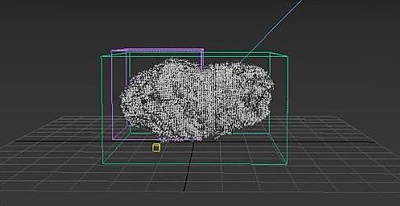

    Please is it possible to make a Volume Grid visible in Modo viewport? I can only see the orange bounding box, but the actual volume shape is only visible when rendered (which takes ages to position/scale right).
    Image below shows how it is displayed in Max, can Vary in Modo do similar?

    Hey, Ondrej,
    Thank you for the post. In case you're using one of the latest nightly builds or even official Next, you will be able to see it in a viewport. The only step is to select the volume grid itself.
    Cheers,
    Boyan Nalchadjiiski | QA Engineer @ Chaos |
    E-mail: boyan.nalchadjiiski@chaos.com
      Hi Boyan,
      Thank you for your response. I'm using older version, so it's the orange box only.
      Thanks anyway.
      O.
