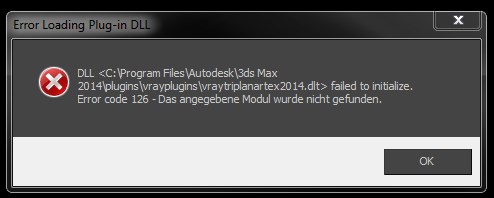

                      Hi,
                      would love to give it a try, but after copying the right file into C:\Program Files\Autodesk\3ds Max 2014\plugins\vrayplugins
                      I get the error message:
                      Any ideas? Thanks
                      marty
                        Which V-Ray version do you have?
                        Vlado
                        • #13
                          good old VRay 2.4
                          • #14
                            It works only on V-Ray 3.x unfortunately; I didn't have time to compile it for 2.x yet.

                            • #15
                              ah, i see. ok, then I´ll keep my fingers crossed..
                              thanks for the quick reply
