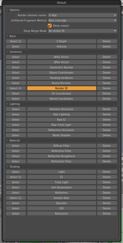

    hi all,
    why I get bad antialiasing on edges in render ID pass? any suggestions?
    thanks

    Unfortunately this element is not supported in vray at the moment. Vladimir will probably have more info for you.
    My workaround for the moment is to disable GI in modo and turn off all other render outputs and render this one output in modo directly. It goes fairly quick rendering it alone.

      it's seems it's supported, i have latest nighlies build. but I got ID pass with very bad antialiasing...
      can't find solution

        That is what I meant, it renders but without AA. If you need it for the moment just render the ID pass in modo. If you search this forum I remember this has been discussed a long time ago, maybe you can get more info there.
          In V-Ray main properties in Render element you have a checkbox "antialias masked render outputs" - it should solve your problem.
          Edit: just checked and it doesn't help in this case...

              Yes, the "antialias masked render outputs" option is intended for anti-aliasing masked alpha outputs, when you are rendering the scene with very simple materials, which will result in V-Ray not taking enough image samples to anti-alias the alpha outputs properly.
              DON'T USE IT when you are doing normal rendering with complex materials, as it can slow down the rendering A LOT.
              See the discussion that starts here : http://forums.chaosgroup.com/showthr...697#post656697

              There is no anti-aliasing because the Render ID is an integer and integer render elements cannot be blended. It is the same in V-Ray for 3ds Max with the VRayRenderID element.
              But MODO's Surface ID is supposed to do something else. I will try to make it work properly and let you know here when it is available in the nightly builds.
              Sorry for making you use this workaround for so long. I think I can make it work almost the same in V-Ray as it works in MODO, and since it will work with V-Ray's anti-aliasing, hopefully you won't have the issues you mention here.
              http://forums.chaosgroup.com/showthr...403#post648403

                For tomorrow's nightly build ( 2016.06.16 ), the Surface ID Render Output is now a color, so it will be properly anti-aliased.
                Also, it will generate a different color for different materials within the same mesh item, unlike before.
                It should be much closer now to what you will get out of the MODO renderer.
                Note that, if you are rendering with simple materials just to create the Surface ID output, the adaptive sampler will most likely not pick up the edges between the materials.
                In this case, switch to the Fixed sampler with 3 or 4 subdivs.
