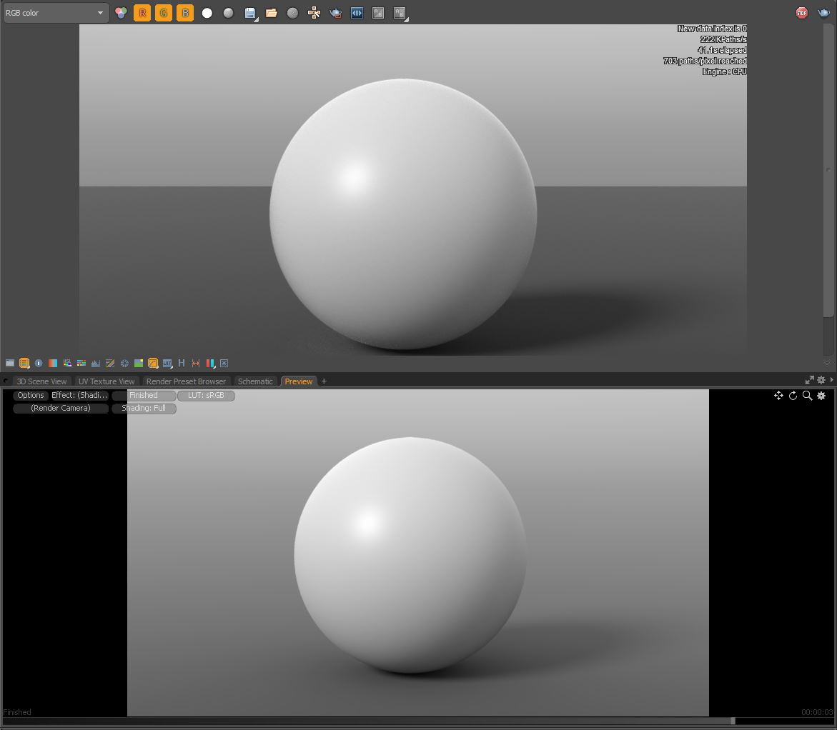

              Seems that even in CPU RT the shadow catcher does not render correctly (screen capture incl)
Name:	VRAY SHADOW CATCHER.JPG
              Carson Jones
              Toronto, Canada.
                Here's a screen capture of a very basic scene. Default Modo sphere and default material using default Modo Shadow Catcher. Same result.
Name:	VRAY SHADOW CATCHER 02.JPG
                Carson Jones
                Toronto, Canada.
                  This is the issue I mentioned when you have EIS enabled.
                  Internally a dome light with the env. texture is created in this case and you are seeing the reflection of that dome light.
                  For these simple environments (no HDR image), you can disable EIS to work around the issue.
