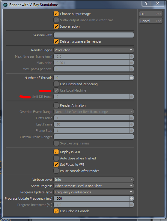

    You can render using the V-Ray Standalone by going to the V-Ray menu inside MODO and then choosing "Render with V-Ray Standalone".
    This will export a .vrscene for you and start the rendering. This type of rendering requires only the render license. The UI license is engaged only during the .vrscene export.
    You can start multiple renders from the same machine, restricting them to only some render servers and disabling "Use Local Machine".
    This way, you will be using only render licenses and looking at the render progress from your main workstation.

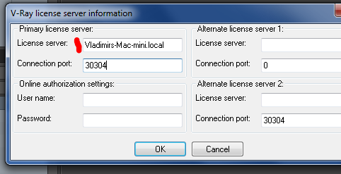

            I am not sure that I understand the situation correctly here.
            Do you mean that your laptop's IP address is changing, so you can't point the render slaves to use it for licensing ?
            You can use the laptop's network name instead of the IP when specifying the license server connection settings.
ID:	863783 Click image for larger version
            You can also use it in the DR host list :

              However, when I export the scene to standalone I do only get the 'don't use local machine' when I enable DR. Otherwise the scene get rendered on the same machine.
              So can't that work without DR?

                  So what ever I choose as option on export Vray does always start rendering. Even when 'use local machine' is turned off.
                  The only thing I can do is to kill the rendering right when it starts. However 'delete vrscene after..' need to be turned off.
                  From that point on I can start the rendering on another computer whit the same path setup. Which is easy.
                  Works on OsX too.
                  So the remaining question is: How can I export a scene without starting it right after?

                    Ah, yes, this is normal, I will add a separate option for this, it was requested by other people too - "Don't start rendering (only export)", which when enabled will mean that "Delete .vscene after render" will be considered disabled.
                    I will also add a separate command to just export .vrscene files (without creating the .command or .bat files).
