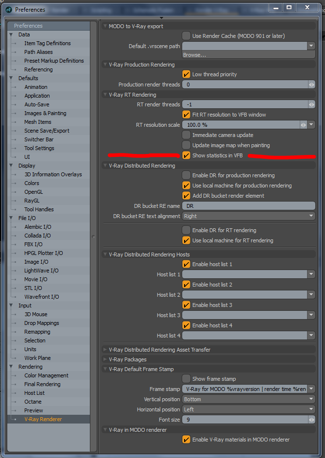

      By the way how to hide infos on the top right corner in RT?
      Edit : Nevermind. For the moment the only way to render it's standalone for RT GPU. I just made a test
        You can do this from the V-Ray Preferences:

          Thx,
          Easy to find actually. grrr
