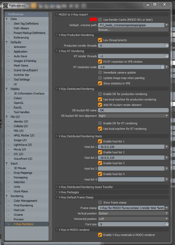

      You need to enable the Use Render Cache preference, so V-Ray will render MODO's Fur material.
      Note that I will make this a per-scene option soon, so it will move to the V-Ray Main tab in the Render item at some point.
      Our own V-Ray Fur is not yet ported to V-Ray for MODO, although it is on the list of things to do.

          Note that for the 2017.05.28 nightly build, the global "Use Render Cache" option is removed and replaced by a per-scene render setting.
