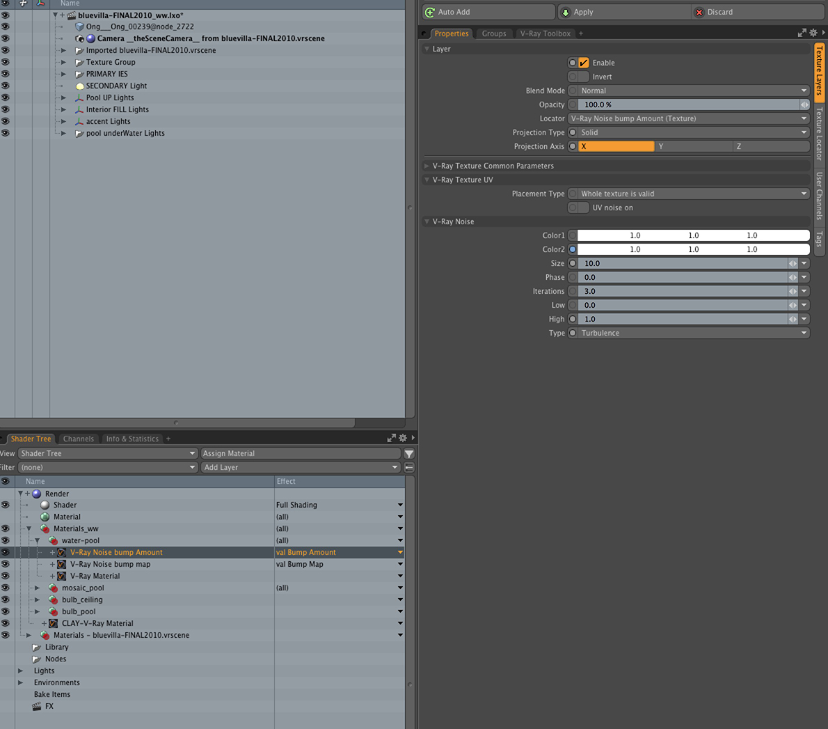

    I have run out of ideas on how to control the bump strength. So far the only way I have found is the value of the 1&2nd colors, when i add the bump amount there is not change other than though the 1&2nd colors and if the bump amount is suppose to be used how should it plug into the schematic setup?
ID:	887750Click image for larger version
    No need to make Schematic connections.
    The val Bump Amount and val Bump Map effects are used only by the V-Ray alSurface material.
    Use the Bump effect that is built into MODO to apply bump to any V-Ray material (including the standard V-Ray Material that you are using).

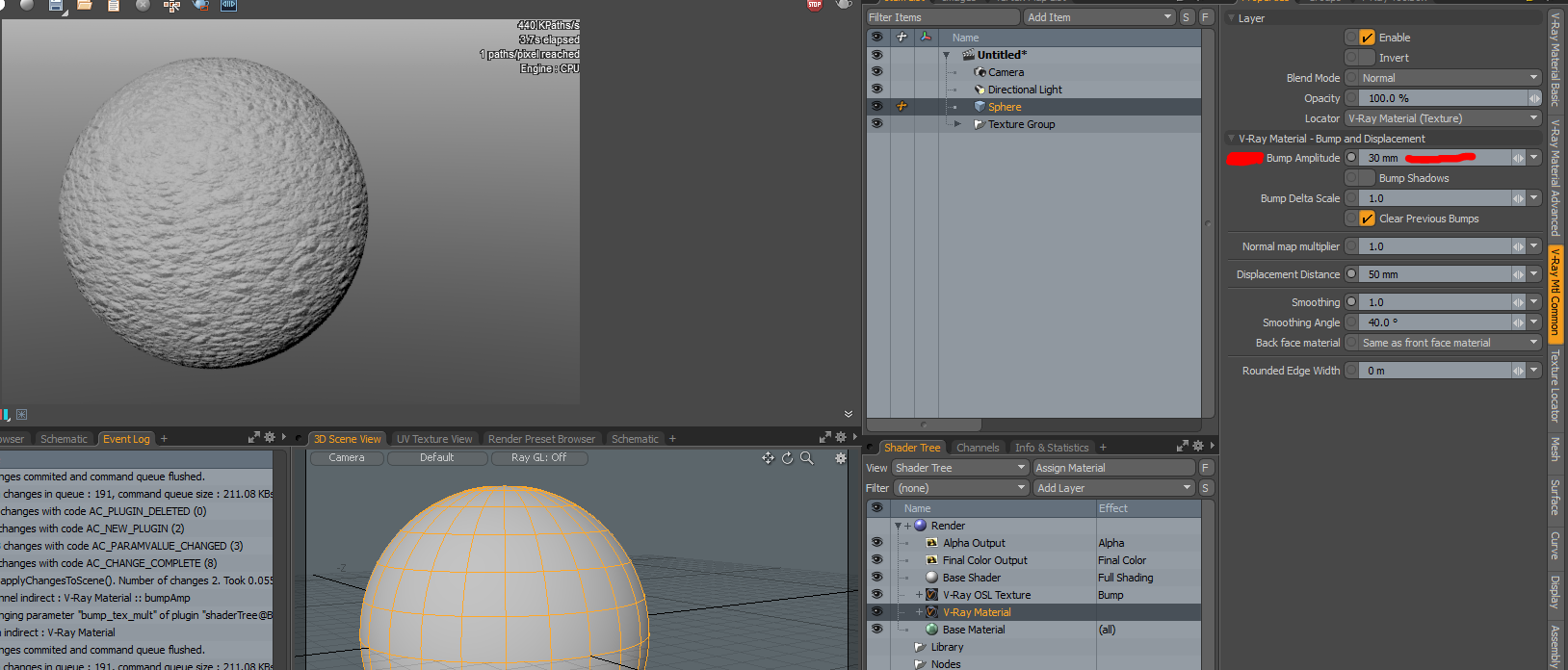

    The bump amplitude is controlled from the V-Ray Mtl Common tab, see screen:
