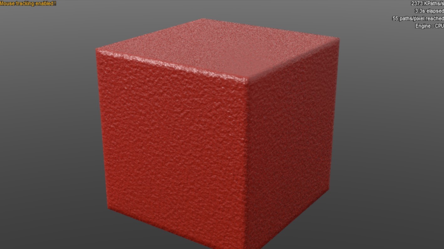

                      First image is a screengrab of V-Ray 4 Preview where the object is close to camera:

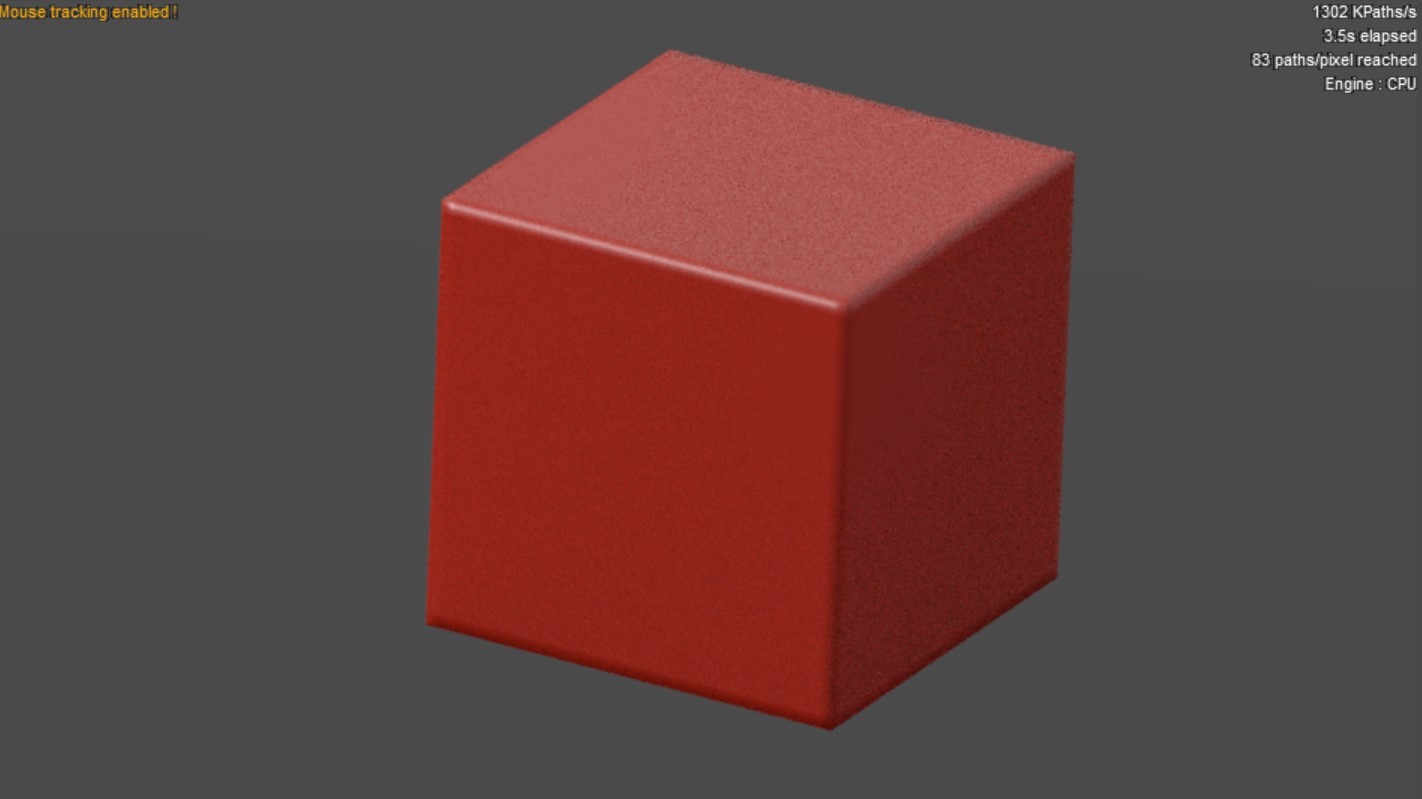

                      Second image is an object far from camera with V-Ray 4 Preview shift-scroll zoomed in on the material. Procedural micro bump has vanished:

                        Originally posted by YabbieSandwich View Post
                        I'm wondering if this bug might have returned in V-Ray 4, seems like the bumps are disappearing at small scale again?
                        I don't think we have resolved this issue in either 3.7 or 4.x.
                        Ok, I think I figured out what's happening. It's only a problem in the V-Ray 4 Preview render (I think!) and it happens when you shift-scroll to zoom in on a material that is far from the camera. The bump seems to render ok in the final render.
                        Yes, the enhanced region will do this. It should be the same in 3.7 and 4.12, you can see the bump starting to be less sharp in the 3.7 image as well.
                        So, if you zoomed in on a region with size 1x1 pixel, blowing it up to 400x400 pixels, the texture will be filtered as if it still has 1x1 pixel size.
                        So, it will get very blurry.
                        I will log an issue to try and improve it.
                        Greetings,
                        Vladimir Nedev
