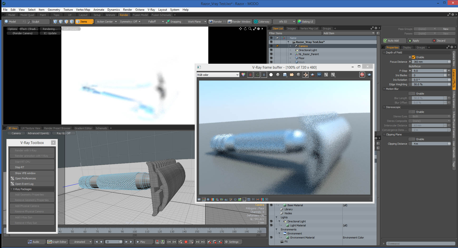

There appears to be a bit of a bug when rendering with depth of field and using small focus distances.
Down to approximately 360mm on the focus distance the zoom amount on the Vray camera stays fairly constant and basically matches the Modo viewport.
The first image is with the focus distance set to 360mm and it matches the viewport.
However the next two images have the focus distance set to 70mm and 45mm respectively, and as you can see this appears to effect the zoom factor quite abit, although the Modo viewport remains constant.
Also there appears to be quite a large disparity between exposure level when using the RT renderer and the final renderer when combined with DOF and these small focus distances. The first three screen grabs were taken of the RT renderer, the fourth image with the same 45mm focus distance as the 3rd image, but is a screengrab of the full Vray render.
