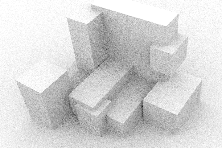

    I noticed strange behaviour of the Ambient Oclusion render output. It reacts on scene lighting and I get good quality only with full lighting and GI enabled. I atached some examples - everywhere universal settings min 1 max 100 with noise threshold of 0.01. It should have the same quality everywhere, also with no lights at all but it looks differently in every lightin scenario.
    Additionaly it reacts to frame buffer image adjustments like exposure, curves, white balance etc. That is not very convenient as it must now be saved separately with all adjustments turned off.

    Here clean example - physically based daylight turned on.
      This happens because of the changes I made described here :
      http://forums.chaosgroup.com/showthr...formance-issue
      Since the AO subdivs get divided by the max image sampler subdivs (in your case 100) and since you don't have any noise in the main RGB element, both the image and the AO sampler take very few samples.
      I've re-enabled AA for the Ambient occlusion render element in tomorrow's build ( 2015-10-22 ), you can manually disable it from the "Antialiasing" channel in the "Render Output" options.
      Do you think there might be a situation where you will want some of these adjustments applied to the Ambient occlusion element ?
      We are thinking about disabling all VFB corrections, except sRGB, on all render elements, except the main RGB one.
      This will affect V-Ray for Max/Maya as well.
