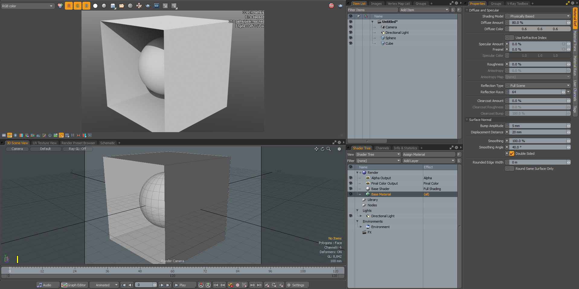

                The "double sided" option of the MODO material is (for the most part) fixed in RT GPU in V-Ray for MODO for the build from 2016.02.24.
                Turns out the most important behavior when "double sided" is off - that back faces are invisible to camera rays, is already supported by the RT GPU core.
                So, it was as simple as modifying the V-Ray for MODO exporter.
                This makes it possible, for example, to put the render camera just outside a wall, invert the wall normals to point towards the inside of the house, and uncheck "double sided" for the wall material.
                You will be able to see inside the house, but the walls will still cast shadows.
                This setup can be found in a number of the MODO samples.
                Here is an example:
ID:	859904Click image for larger version
                There are still some specifics to MODO's "double sided" option that are not available in the RT GPU core it seems. We might add those in the future.
                It seems though that the "double sided" option is not the main reason for the differences in the original scene. Still looking into that.
