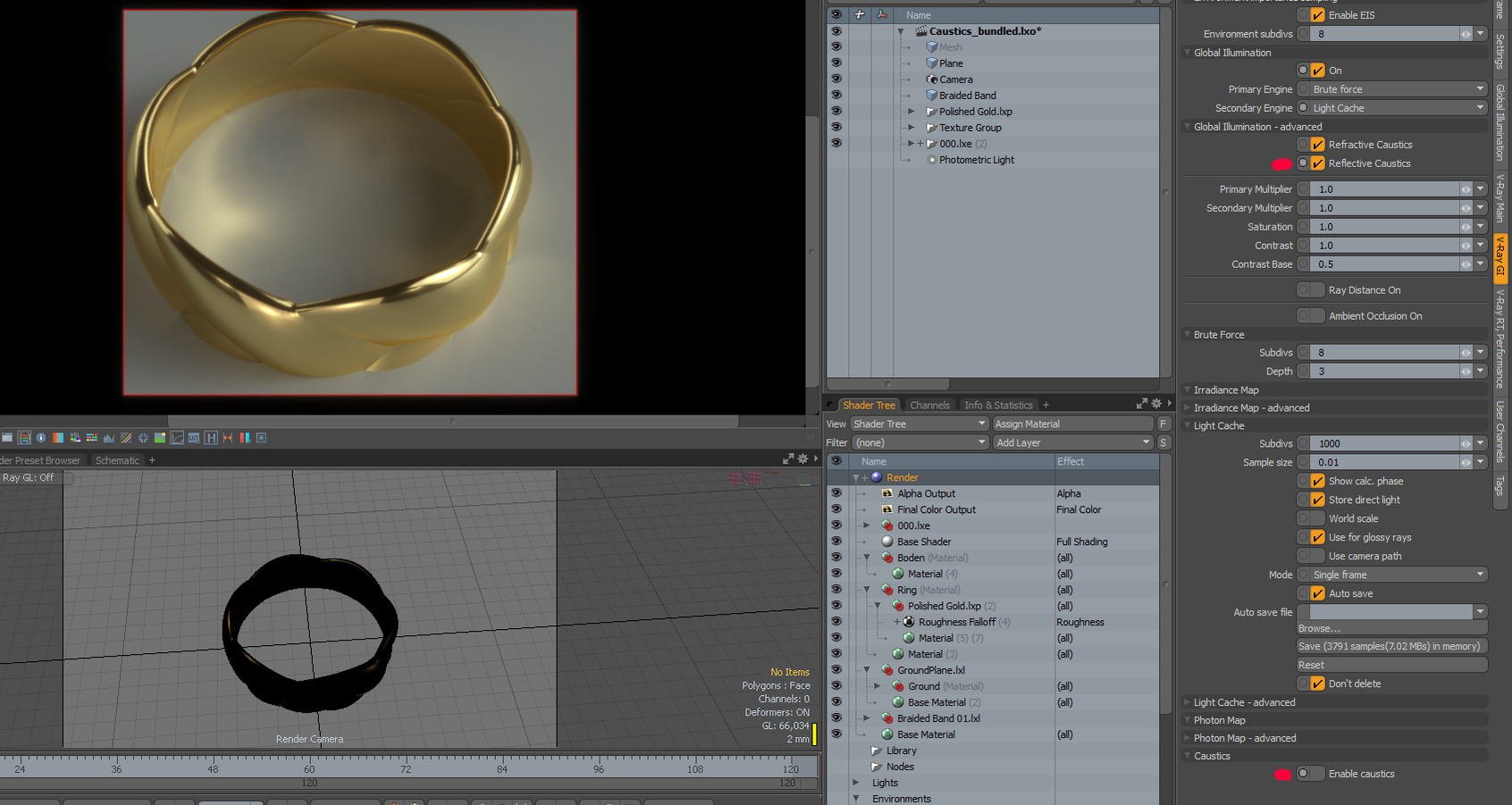

                Hmm, I’m not sure. If I switch caustics on, Modo is not rendering any caustics. But if I switch on „Volumetrics“ the caustics appear. :-/
                Indirect caustics are shown in Preview. Mostly I work with indirect light. Nearly no of my scene has any other kind of light.
                Here is the scene file of my caustics test: https://dl.dropboxusercontent.com/u/...usticsTest.zip
                  Reflective caustics like the one in this scene are disabled by default in V-Ray, since they can introduce a lot of hard to clear noise.
                  Vlado made improvements to handling these though, and I am not completely sure, but we might enable them by default in the near future.
                  See attached image. You also have to disable the caustics map, as in this case it gives a worse result than directly tracing the reflections.
                  This is because there is no light in the scene (the IES file wasn't in the bundle).
                  With environment importance sampling, the environment gets turned into a Dome light, but I haven't exposed any parameters to control its caustics generation.
                  So you can't fine tune it for a good result.

                    I have updated the scene file. This IES is part of the Modo distribution too.
                    Ah, there is an additional caustic setting in the „Gobal Illumination Advanced“. I didn’t know it. Thank You.
