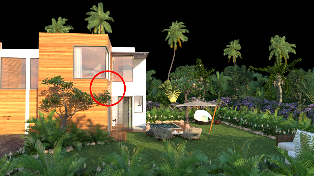

    I am rendering an animation through VRay standalone submitted with modo with a set of renderslaves. I am using the release Version of VRay not the nightlies yet.
    And I get flickering discolored buckets. I have attached three frames that illustrates the problem.

    Do you have your environment invisible to GI, reflection or refraction rays ?
    Maybe it is the same problem reported here : http://forums.chaosgroup.com/showthr...rradiance-Rays

      Hi Vladimir,
      have installed the latest nightly build - thanks a lot! Will try it tonight.
