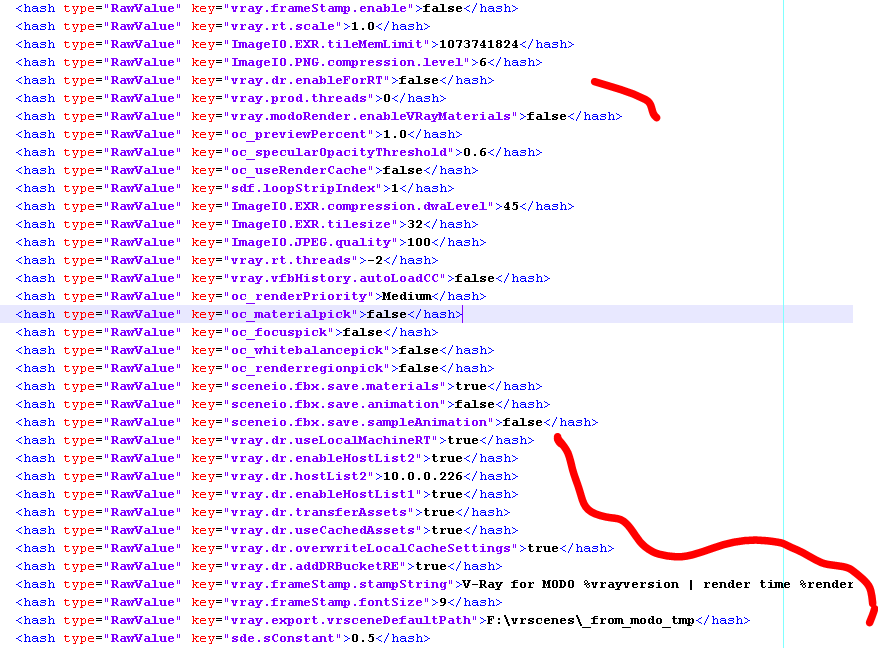

        You can open the .cfg file and search for UserValues.
        Then inside that you can search for vray. and delete all RawValues that were stored for V-Ray.
