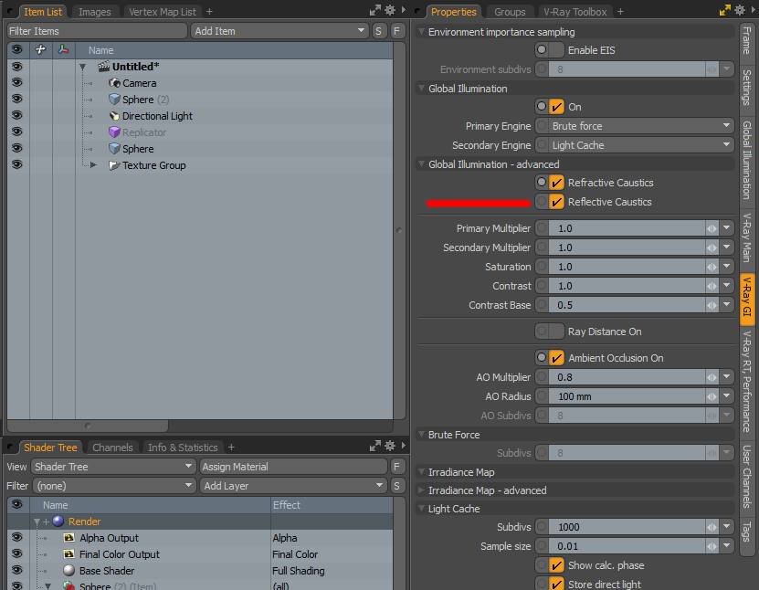

    - disable reflective caustics

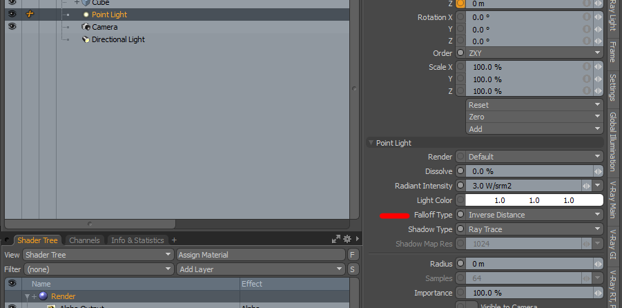

    - change the Falloff Type of the your points lights to Inverse Distance or None. Then you can decrease their intensity, and the hot spot will not be so bright and cause so much noise.
