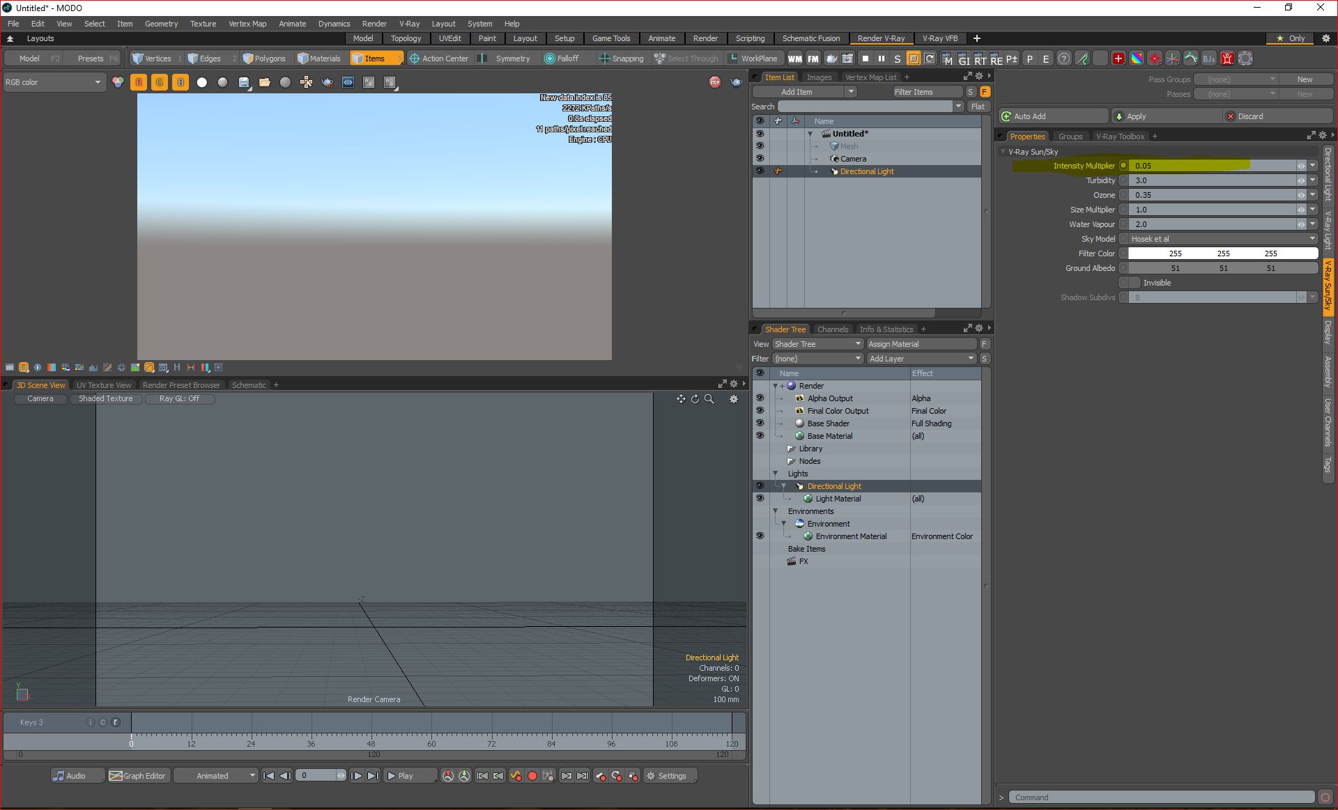

      Hey Ratus69,
      Thanks for the post. There two ways to fix that. First one is to reduce the V-Ray Sun intensity to 0.06-7. Go to Render Vray tab -> pick the Direct Light -> Properties panel-> Vray Sun/Sky.
      The second way is to convert the Modo camera to Vray physical camera. Check the attached file.
      BR Boyan

        @GidPDX : thanks but environment intensity did not work at all
        @Boyan : it's working with both solutions !
        I added the sun&sky package but I didn't thing I would have to go so low to diminish the clamp
        I like the vray camera, I can manage the light easily with the F-stop parameter like a digital camera
        thanks to both of you for your fast help !

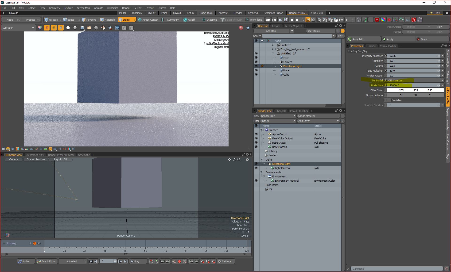

          arf, an other problem I have related to sun&sky :
          I tried to use in sun&sky a CIE overcast sky model but my shadows stay sharp
          In fact I can change any of the sky model, there's nothing changing, looks like modo environment is taking control over it
          changing camera to vray physical or removing the environment material doesn't work
          thanks

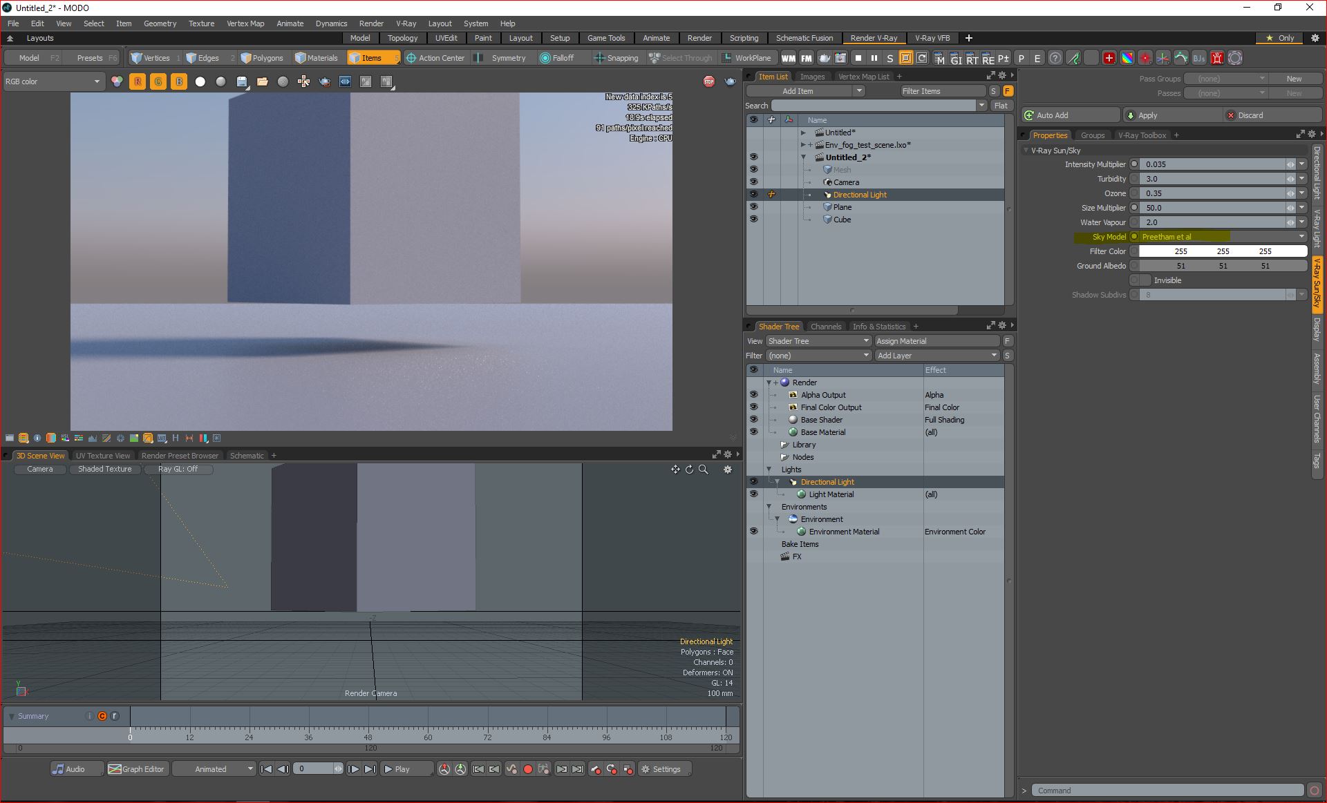

            Hey ratus69,
            Appreciate your post. As attached file are few examples of a sun and sky models.
            BR Boyan

              wonderfull boyan, size multiplier was the parameter I was looking for !
              sky model looks like more for the color environment
              thanks a lot !
