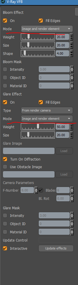

        Hey Robert,
        Just set the Mode in the Lens Effect panel to Image and Render Element. It will render a specific pass with the lens effects on a black background.
          Hi John, I tried all kind of combinations. But What ever I do I get two output a mask and Glare/Bloom output, these outputs are always on the RGB output. I render with denoiser, so its totally waste to have it on a standard RGB output. Maybe its a bug?
          The only time I get a black background is when I turn off all GI and Lighting in the scene. But thats a bit contra productive.
