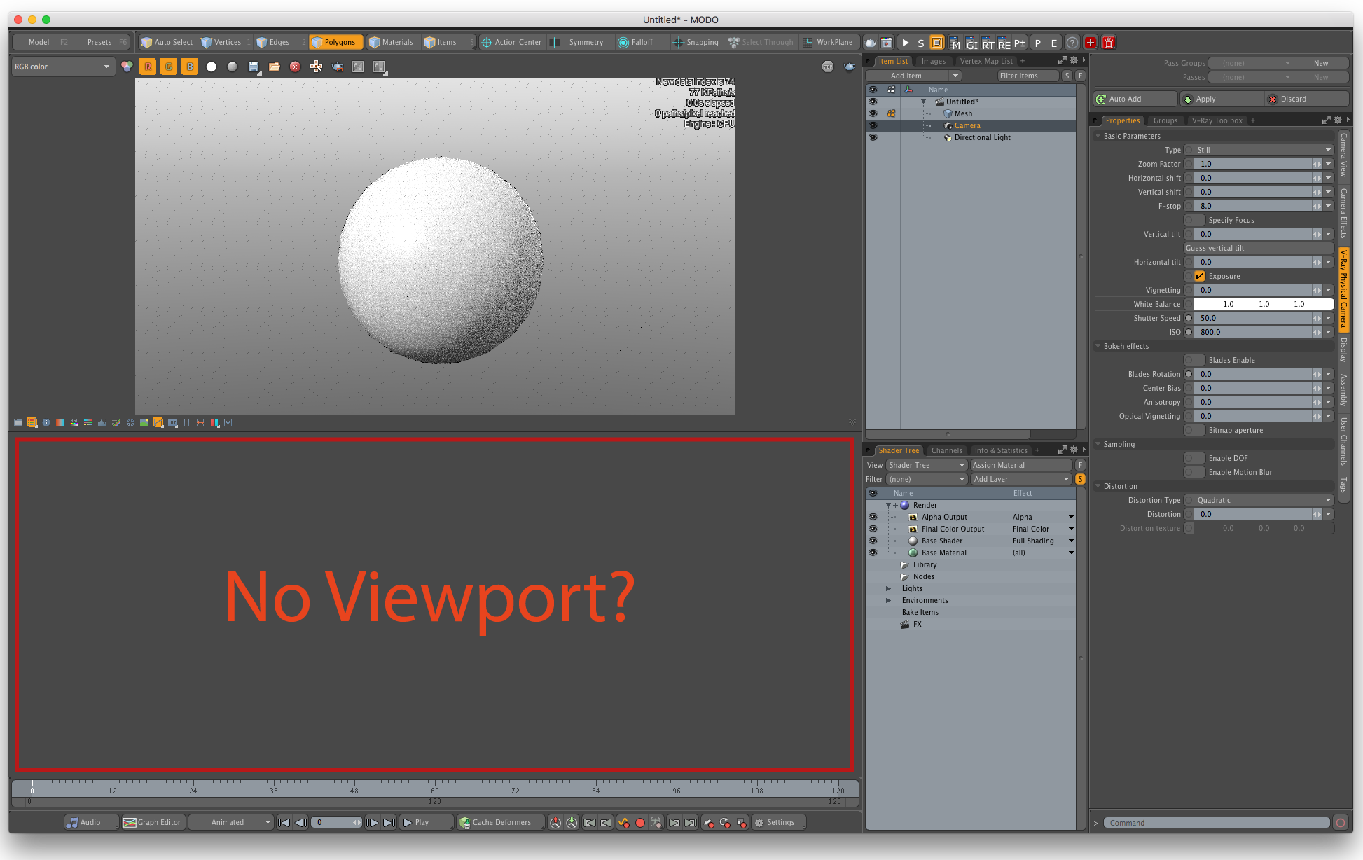

    Hi,
    I've downloaded and installed "vray_adv_34002_modo_mavericks_x64_27013"
    and now I get no viewport as shown on the screen grab attached.
    Is it just me, I may be missing something blindingly obviousClick image for larger version
    Try resetting the Render V-Ray layout by double-clicking on its tab.
    Greetings,
    Vladimir Nedev

        You have the 3d view-port maximized ( the yellow arrow ).
        Greetings,
        Vladimir Nedev
